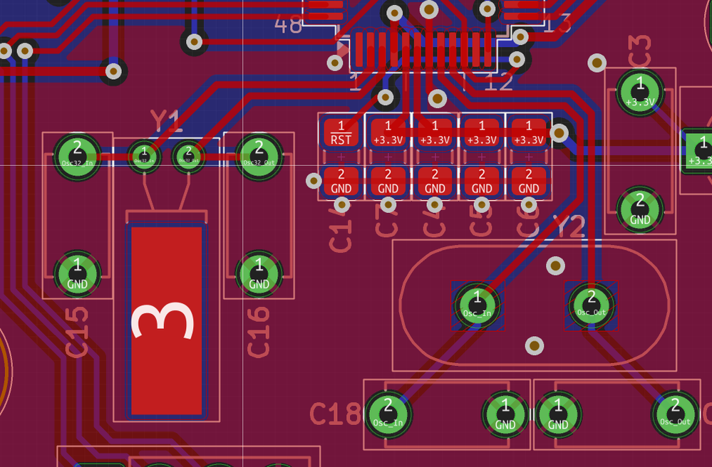

waclawek.jan
Tell us more about yor hardware. Show layout of LSE oscillator, including ground arrangement.
Also, check the errata.
Hi!
In this MCU pin 1 is RTC_OUT1. Originally I didn't consider the RTC_OUT pin, so that there's not connection over it; however, I'm getting it through a wire. It must not affect the output frequency because it's supposed that the crystal circuitry is isolated from the pin.
Board is two layers with a massive ground planes in both of them as can be seen.

waclawek.jan
The LSI errata is probably not pertinent to this problem.
Don't use the common ground plane to return from the capacitors around the crystal; use a dedicated track as short as possible. Read AN2867, pay attention to the provided layout example.
Due to the PC13-related erratum, there may be no solution to given problem, as long as you stick to that pin.
