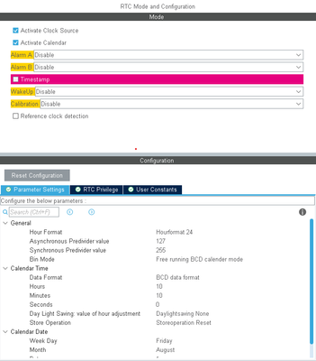

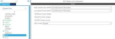

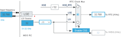

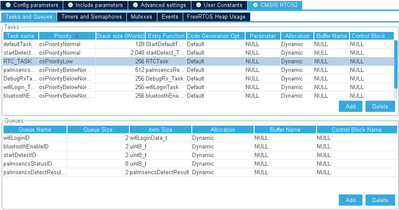

We are trying to enable the RTC with FreeRTOS on the STM32U575AII6. The settings are as follows:
1.RCC
2.RTC
3.Clock
4.freeRTOS

The seconds displayed above are wrong.
Any suggestions would be greatly appreciated. Thanks in advance!

If you clock it with LSI, does it work as expected? If so, LSE isn't working right.

2.If you clock it with LSI, does it work as expected? If so, LSE isn't working right.
I tried to switch the RTC clock source to LSI, and it’s working well.
Thanks again.
