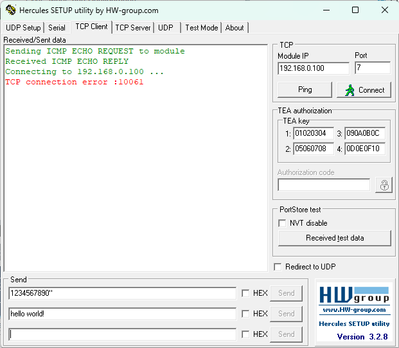

  • TCP client/monitor: Hercules v3.2.8
  • I can ping the board successfully every time (with Windows terminal and Hercules)
  • However, I cannot establish a TCP connection when FreeRTOS is enabled
What’s confusing me is that:
  • If I disable FreeRTOS, I can successfully establish a TCP connection using the CubeMX example LwIP_TCP_Echo_Server
  • Once FreeRTOS is enabled, the TCP connection attempt from Hercules fails (no connection established)

Below is a screenshot of my Hercules TCP client configuration and the messages shown when attempting to connect.

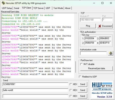

This same error (or similar) appears across different Free + LwIP projects I've tested. For reference, below is what I get when I use the LwIP_TCP_Echo_Server (no FreeRTOS) example from the CubeMX example selector for the NUCLEO-H723:

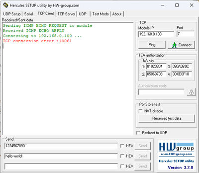

I tested the updated project on my end, but unfortunately I am still unable to establish a TCP connection. Below is a screenshot of my latest connection attempt from Hercules:

Thank you for pointing out the network configuration change, I initially missed that. After updating the IP configuration to match my local network, I retested the project.
At first, the board stopped responding to ping when configured with 192.168.0.100, and my PC reported the address as being outside the local network range. I have previously been able to ping this address reliably, but after changing the IP to one within my current local subnet, ping started working again.
With the corrected IP:
  • Ping works reliably
  • TCP connection on port 7 still does not establish

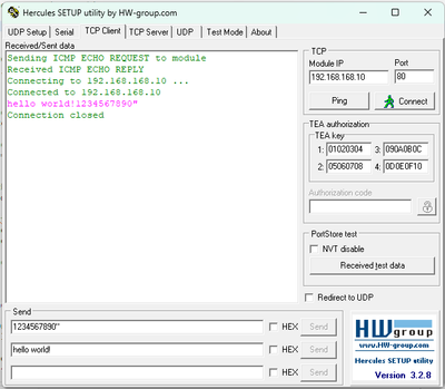

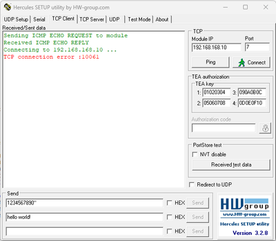

Out of curiosity, I changed the server port to 80, and in that case I am able to establish a TCP connection successfully. However, the connection only remains open for about 1–2 minutes before it is forcefully closed.
Below are screenshots showing:
  1. The failed connection attempt on port 7
  2. The successful connection on port 80 (before it eventually disconnects)

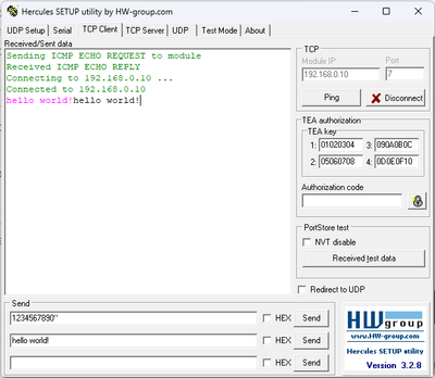

Just wanted to follow up and close the loop on this.
After adjusting my PC’s Network & Internet settings as you recommended and ensuring both the PC and the board were on the same subnet, I was able to get my desired static IP address working (192.168.0.100) on port 7. The TCP server now connects reliably, and ping and data exchange are working as expected.
Below is a screenshot showing the successful connection and data exchange in Hercules:
Thank you for the guidance, this ended up being a network configuration issue on the host side rather than a problem with the STM32/LwIP configuration.
