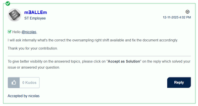

mƎALLEm
Hello @nicolas,
I will ask internally what's the correct the oversampling right shift available and fix the document accordingly.
Thank you for your contribution. Internal ticket 221624.

mƎALLEm
Hello @nicolas ,
OVSS[3:0] supports up to 15 bit. Therefore, limit to 10 bit and reserved values in bitfield description will be removed. in RM0456.
