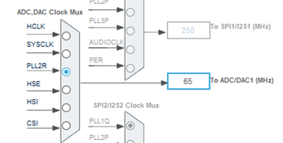

IOC file selects PLL2R for 65 MHz ADC clock...

Another observation: HAL_RCCEx_GetPeriphCLKFreq(RCC_PERIPHCLK_ADC) returns 250 MHz, not 65 MHz as I expected. Still doesn't explain why I measure 3.9 ms for average conversion.

if the ADC is indeed running at 250MHz :
  • 3 * 256 * (640.5 + 12.5)) / 250000000 = 2.0ms / sequence
  • TC count = 60102 for 120 seconds = 1.99ms / sequence
Could you please share your RCC/ADC clock config?

PeriphCommonClock_Config()...
void PeriphCommonClock_Config(void)
  RCC_PeriphCLKInitTypeDef PeriphClkInitStruct = {0};
  /** Initializes the peripherals clock
  PeriphClkInitStruct.PeriphClockSelection = RCC_PERIPHCLK_ADCDAC|RCC_PERIPHCLK_SPI4;
  PeriphClkInitStruct.PLL2.PLL2Source = RCC_PLL2_SOURCE_HSE;
  PeriphClkInitStruct.PLL2.PLL2M = 8;
  PeriphClkInitStruct.PLL2.PLL2N = 40;
  PeriphClkInitStruct.PLL2.PLL2P = 2;
  PeriphClkInitStruct.PLL2.PLL2Q = 2;
  PeriphClkInitStruct.PLL2.PLL2R = 2;
  PeriphClkInitStruct.PLL2.PLL2RGE = RCC_PLL2_VCIRANGE_1;
  PeriphClkInitStruct.PLL2.PLL2VCOSEL = RCC_PLL2_VCORANGE_WIDE;
  PeriphClkInitStruct.PLL2.PLL2FRACN = 0;
  PeriphClkInitStruct.PLL2.PLL2ClockOut = RCC_PLL2_DIVQ|RCC_PLL2_DIVR;
  PeriphClkInitStruct.AdcDacClockSelection = RCC_ADCDACCLKSOURCE_PLL2R;
  PeriphClkInitStruct.Spi4ClockSelection = RCC_SPI4CLKSOURCE_PLL2Q;
  if (HAL_RCCEx_PeriphCLKConfig(&PeriphClkInitStruct) != HAL_OK)
    Error_Handler();

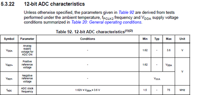

To corelate ADC conversion rate with a thread period I changed ADC prescalar divisor from 1 to 2, and decreased oversampling from 256x to 64x. Other ADC parameters unchanged.
I suspect HAL_RCCEx_GetPeriphCLKFreq(RCC_PERIPHCLK_ADC) is not returning ADC clock correctly because:
  • Datasheet shows max ADC clock 75 MHz
  • Conversion times change as expected when I change ADC prescalar (now that I know HAL_ADC_ConvCpltCallback does not count HT)
With ADC prescalar divisor at 1, the ADC counts I read are not accurate. With ADC prescalar divisor at 2 or more, the ADC counts I read are as expected.
Could I be overclocking the ADC?
