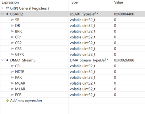

I am trying to receive data over usart using dma with LL. I'm stuck with this for one week. I need help please.
11 replies
waclawek.jan
April 11, 2023
Which STM32?
What are the symptoms? Can you receive from the same pin using polling? Are clocks of DMA, USART, GPIO enabled in RCC?
Read out and check/post content of USART, DMA and relevant GPIO registers' content.

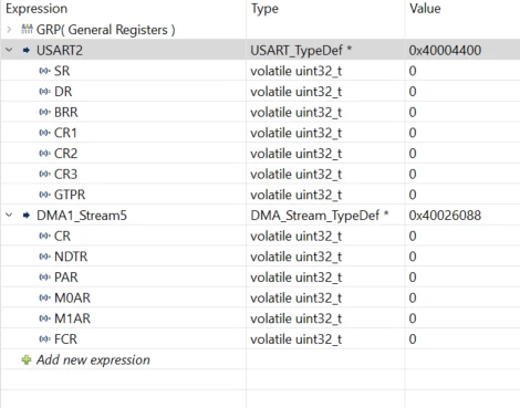

stm32 f407
I don't know if the image is clear, but all the registers are empty

If all the UART registers are zero, Tx can't work. It means, you've read out the registers content while UART and DMA were not set up yet - just after reset, perhaps? That's not useful.
Read out the registers after they've been set up, and then again after some characters have been sent to Rx; check, compare, post.

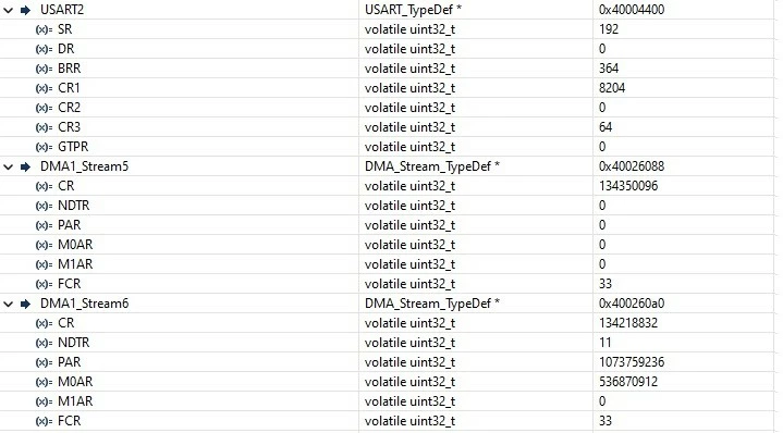

My bad, I did not take the screenshot at the right time. Here are the registers, TX is working, RX is empty
waclawek.jan
April 13, 2023
Okay, so if DMA1_Stream5's NDTR and both address registers (PAR and M0AR) are zero, you obviously don't write into them, do you. So how could it work?
Please try to check the registers yourself and try to figure out what's going on. You can step through the program while observing the registers. Decimal display of registers is rarely useful, too.
