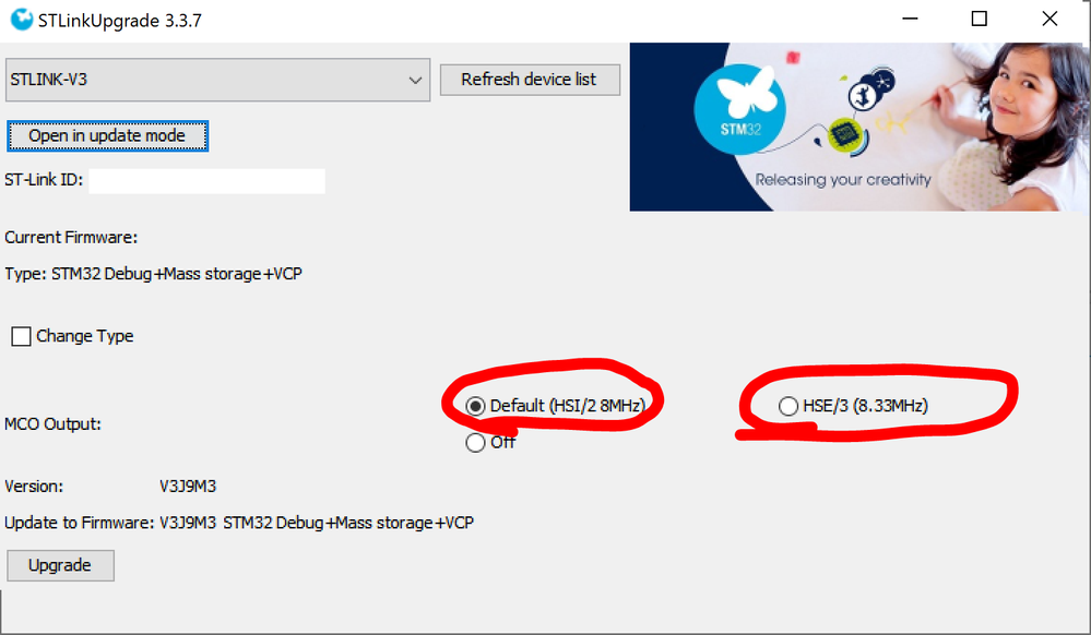

I'm trying to use a Nucleo-H753ZI board for an audio (SPDIF) project and, compared with the Nucleo-F746 board I was using, the clock quality is abysmal - off frequency and with loads of phase noise. It appears to be derived from the HSI on the ST-LINK device (F723) rather than the 25MHz crystal oscillator (why 25MHz, why not 8MHz?). Has anyone else had issues with this? I've raised a support case with ST (case no 145713) but I'm not expecting a ST-LINK software fix anytime soon, even if it is possible.

The clock that the ST-Link provides the chip is configurable on these boards. During ST-Link upgrade, you can select from HSI-based 8 MHz or HSE/3 (8.33 MHz).

Ah, right. I didn't notice that when I first plugged the board in and it wanted to upgrade ST-LINK. I'll have to think about 8.33MHz. It doesn't really play too well with multiples of 48kHz for audio, but I may find some appropriate PLL settings. Thanks for the tip anyway.

You can't, not exactly. However I put in 8.33333333 MHz to MX, which is well into 1ppm territory and much better than the actual crystal oscillator spec. With DIVN1 at 115 and the fractional-N set to 1638 on the main PLL I can get a system frequency of 479.999777 MHz which is not bad. The drawback of fractional-N in some critical applications using the ADCs is that the process introduces some clock jitter as the N1 divider is at 115 some of the time and 116 the rest of the time. For my app with SPDIF it's not a problem as the jitter is far less than with the HSI clock and I'll have an easier time building a tracking loop to set the output packet rate to follow the input rate.

You can place an extra quartz on the X3 footprint.
You have to set 2 capacitor and move some solder drops.
Refer to the avalable board schematics.
