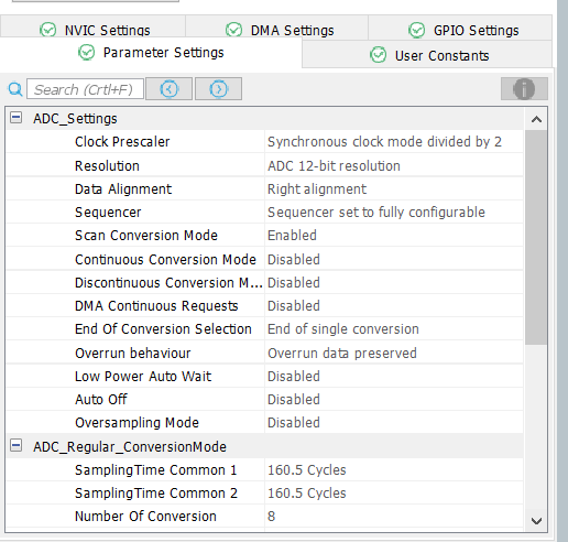

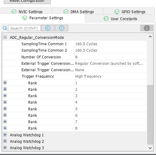

I'm trying to read 9 ADC inputs on the G070 MCU using the interrupt method. Unfortunately, under the number of conversions setting I can only do 8 conversions.
Is there a way around this?

Ryan Coleman
We originally tried to use DMA but couldn't get it to return values. Sounds like it might be time to revisit.
Do you know if the interrupt method is limited to 8 conversions? Or am I missing something in the configuration?
The sequencer (choosing an arbitrary order to convert channels) is limited to 8 channels.
Disable the sequencer and you can convert as many channel as you have selected. Channels can be converted in forward or reverse order.
DMA and IT have the same limitations here. Switching to DMA won't help.
