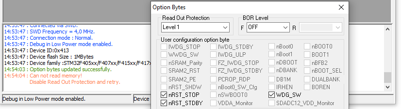

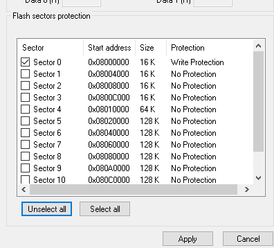

Hi, I am using stm32f407vg. There is no read/write protection for sectors, there is only write protection option. 0693W000000VdujQAC.png
So I had to enable read out protection, when I change protection level 0 to 1, code doesnt work. It's not working for even led blink code. Should I do something before chancing protection level? I am just downloading code then changing protection level. When I change 1 to 0 and download same application, it works. What should I do? Thanks.
Correct, the F2/F4 design doesn't have selective read protection.
Read Out Protection is an array level control.

Of course I am not trying to download when Read Out Protection level is 1. When protection level is 0 I download the code and see led is blinking, UART is sending messages, then I only change protection level, nothing else. Same code should work but after I change protection level 0 to 1 from STM32 ST-LINK Utility, led is not blinking and UART is not sending anything. What I meant was that.

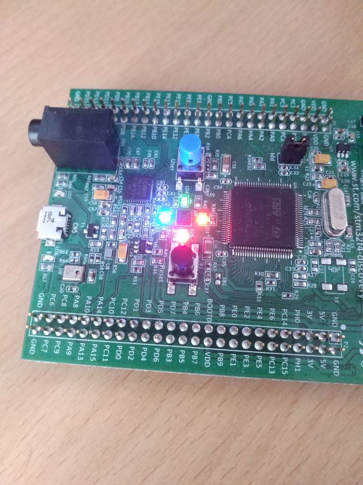

Try some very simple program first, only blinking LED and NOTHING else.
Then I changed protection level.
And nothing is working.

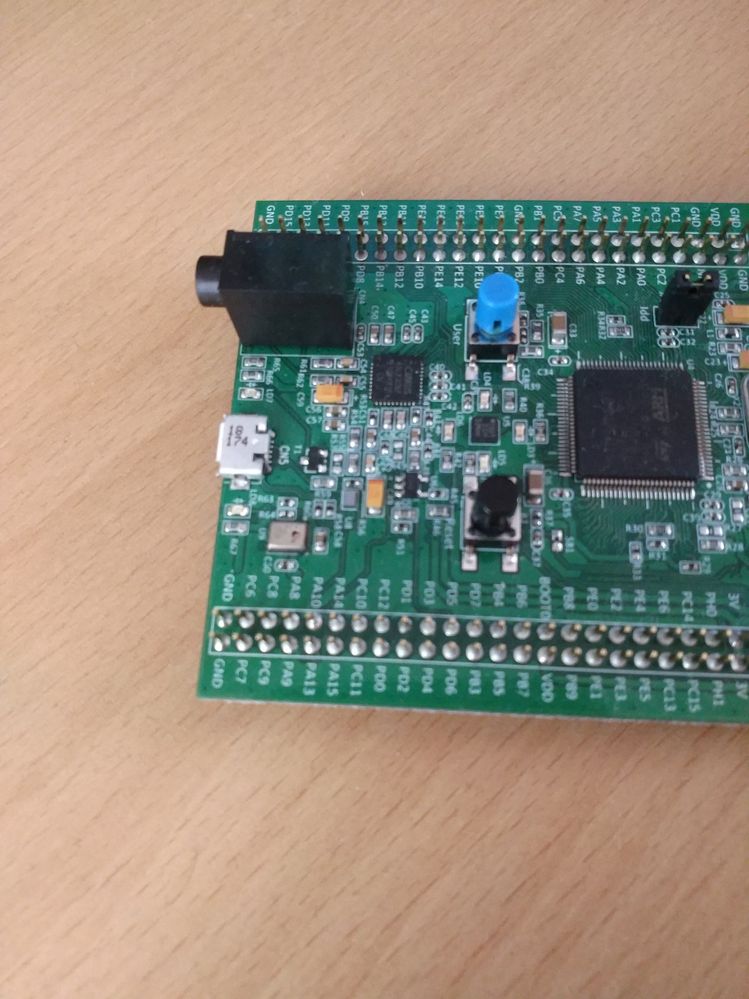

Couple of weeks ago, I touched to on board debugger and static killed it, I cant use that debugger anymore so I am using external debugger. Maybe static also damaged MCU, is it possible? It may be nonsense because without read out protection everything is working fine.
