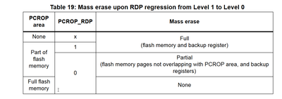

After this, I reduce the RDP level from 0 to 1 and, when checking the data integrity of the last sector, I verify that the entire sector was set to zeros. The sector is not erased, as expected based on the table bellow (reference manual in page 89, table 19) nor maintains its data integrity, which violates my requirement - 3) If the read protect is lowered, the data in the last sector must be unchanged.

@Danish1 The PCROP protected area(s) are excluded from mass erase, if some option bit is set. Likely, this is what the OP wants.
But, in case mass erase worked, the erased flash should read as all FFs. The OP says it reads as 0. This hints that the PCROP area indeed has survived RDP regression.
I tried to read the region I protected with STM32Programmer and observed unprotected areas with FF and the protected one with 00.
