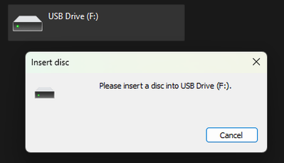

"Please insert a disk into USB Drive" USBX MSC+FILEX+LVLX+THREADX
Silexman
I am working on a project to connect QSPI flash memory to a PC as a USB mass storage device (MSC) using USBX, FILEX, LVLX, and THREADX on an STM32. This setup should allow the QSPI flash to appear as a drive in Windows.
Previously, I successfully implemented a similar project using the MCU's internal RAM as the storage medium. However, after switching to QSPI flash, I encounter the error message: 'Please insert a disk into USB Drive' when connecting the device to a PC.
To debug this issue, I tested the QSPI flash read/write functionality using FILEX + LVLX + THREADX without USBX, and it worked perfectly. This suggests the problem lies in the integration with USB MSC.
I am including my code for review. Could anyone help identify any potential errors or missing steps in my implementation? Additionally, are there specific areas I should focus on to resolve this issue? Thank you.

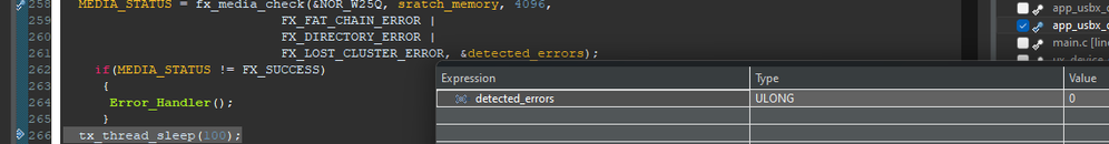

I tried read/write operations again using FileX+LevelX+ThreadX as in this example project, formatting the media to 4096 bytes per sector, and the read results matched what was written earlier. I also checked the media using fx_media_check, and the result showed no errors on the media.
Additionally, I changed the media format to 4096 bytes per sector in the USB MSC project. I also checked the media through Disk Management in Windows with the following results. Still not working so far

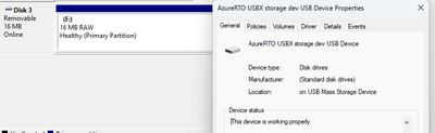

Halo @Haithem Rahmani Thank you for the replay.
After I accessed it using LevelX, the USB MSC feature didn’t work initially. However, after formatting it using the formatting tool in Windows, the USB MSC started working, and I could read and write files. The problem is, whenever I unplug the USB—whether the device is powered or not—the files I saved become corrupted. What steps should I take to identify and resolve this issue?
edit : after I changed the sectore size to 512 bytes, the issue is gone

Thank you very much! It seems that i managed to make it work following your code.
Can you confirm that you set FX_NOR_QSPI_SECTOR_SIZE to 512?
I also had to modify:
#define LX_STM32_OSPI_SECTOR_SIZE 512
and add also LX_STM32_OSPI_BLOCK_SIZE define so that levelX knows that the underlying flash geometry has a minimum erasable block size of 4kb.
#define LX_STM32_OSPI_BLOCK_SIZE                            4096
#define LX_STM32_OSPI_FLASH_SIZE                            W25Q16JWXHIQ_FLASH_SIZE
INT lx_stm32_ospi_get_info(UINT instance, ULONG *block_size, ULONG *total_blocks)
    INT status = 0;
    *block_size = LX_STM32_OSPI_BLOCK_SIZE;
    *total_blocks = (LX_STM32_OSPI_FLASH_SIZE / LX_STM32_OSPI_BLOCK_SIZE);
    return status;
It's quite frustrating that the concepts of "sectors" and "blocks" have different meanings through the whole levelx, usbx and stm32 nor drivers toolchain.
So basically, if i got it right, LevelX works with 512 bytes logical sectors, that are grouped in blocks. The number of sectors in one block depends on how the user configures the low level NOR driver and are set runtime by levelX when "lx_nor_flash_open" is called. In my case I used the minimum erasable unit of the flash (4kb), but also the larger 64kb block could be used.
