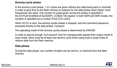

I want to understand the correct way to read this instruction UNIQUE ID (4Bh). To get this value, the datasheet says after the INSTRUCTION (4Bh) I need to add 4 bytes of DUMMY clock (32 clocks). After this, I will able to receive the 64 bits from the UNIQUE ID.
I'm a little confused about my tests and would like some help from the community to know if some of the two paths I show below are correct or none of them haha
1) My first try was using the code below, but I always get corrupt data.
- I put the max dummy cycles allowed (31). Check it on the HAL lib and reference manual.
- read 8 bytes (64 bits from the UNIQUE ID)
Looking the logic analyzer, I figure out the data is shifted to left. The last byte was not readed.
2) The second try was the code bellow:
- I sum the 8 bytes from UNIQUE ID with the Dummy bytes.
- the first 4 bytes are zero and the UNIQUE ID start at index 4 in pData array.
Looking the logic analyzer, the data is fine.

In your experience, the way I'm reading the UNIQUE ID register is correct? Read 12 bytes, discard the first 4 bytes and consider the rest of the array.

Well, your second try was correct. In the dummy-cycle phase, the microcontroller can allocate a maximum 31 cycles, however the memory needs 32 cycles to process the read ID.
Here is another option you can consider.
s_Command.DummyCycles = 31; //31 bits of dummy cycles
s_Command.NbData      = 8+1; // 8 bytes of data + 1byte as dummy

@FBL thanks to confirm the quantity of dummy cycles.
I'll use my second try. Thanks for your support here.
