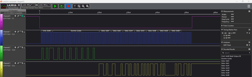

Hi ST community!
I'm a liltle confused about how to read the UNIQUE ID from memory NOR W25Qxx. In my case a use the W25Q128 - https://www.winbond.com/hq/product/code-storage-flash-memory/serial-nor-flash/?__locale=en&partNo=W25Q128JV
We already use this memory in another custom boards.
We able to flash, create external loaders and use it with touchgfx.
This custom board has a STM32H753.
I want to understand the correct way to read this instruction UNIQUE ID (4Bh). To get this value, the datasheet says after the INSTRUCTION (4Bh) I need to add 4 bytes of DUMMY clock (32 clocks). After this, I will able to receive the 64 bits from the UNIQUE ID.
I'm a little confused about my tests and would like some help from the community to know if some of the two paths I show below are correct or none of them haha

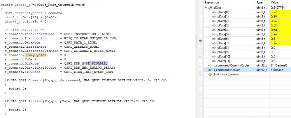

1) My first try was using the code below, but I always get corrupt data.
- I put the max dummy cycles allowed (31). Check it on the HAL lib and reference manual.
- read 8 bytes (64 bits from the UNIQUE ID)
Looking the logic analyzer, I figure out the data is shifted to left. The last byte was not readed.

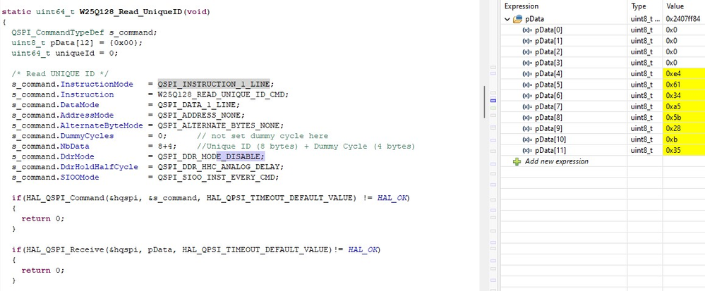

2) The second try was the code bellow:
- I sum the 8 bytes from UNIQUE ID with the Dummy bytes.
- the first 4 bytes are zero and the UNIQUE ID start at index 4 in pData array.
Looking the logic analyzer, the data is fine.
Please, anyone can advise me the correct way to read this UNIQUE ID from W25Q128 NOR memory?

Hello @uilter,
Some updates in the configuration should be adjusted:
s_Command.DummyCycles = 4; //according to the datasheet
s_Command.NbData      = 8; // 64bits
If still facing issues, please keep me updated!
To give better visibility on the answered topics, please click on "Best answer" on the reply which solved your issue or answered your question.Best regards,FBL

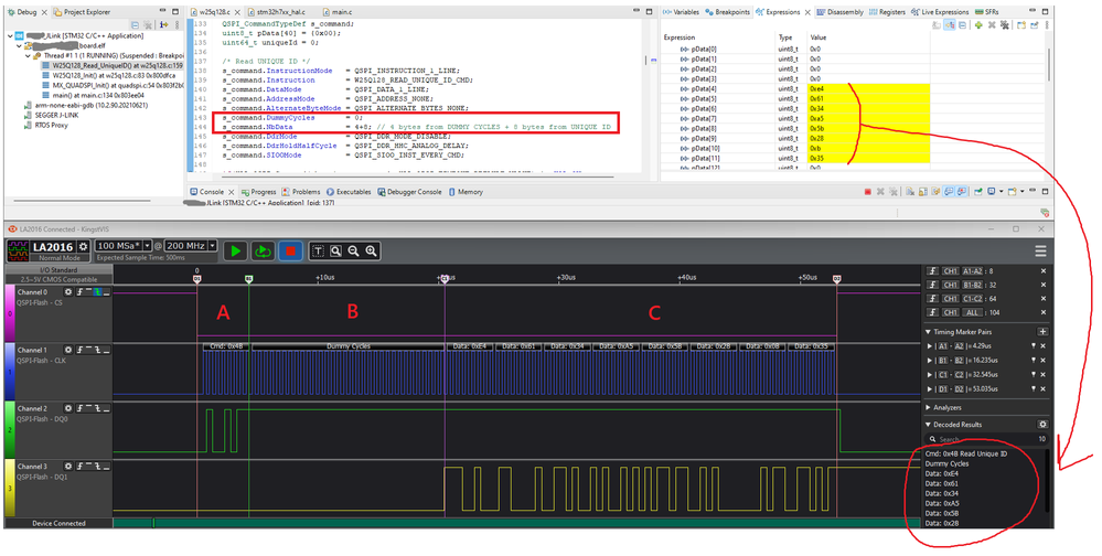

We did tests in 3 different boads. All custom boards has this memory (W25Q128xx).
The difference between this board is the MCU: STM32H753BI, 753II and 753ZI.
The following image show the code to read this UNIQUE ID and bellow the logic analyzer.
You can see the debug mode, the array pData match with the logic analyzer.
We setup the logic analyzer adding time markers and a counter in CLOCK line of the QSPI.
According the datasheet, we need in total 104 clocks, splitted in:
- A marker, 8 clocks: instruction (4Bh)
- B marker, 32 clocks: dummy cycles
- C marker, 64 clocks: 64-bits UNIQUE ID
- D marker, total of 104 clocks. This match with Figure 42 wave form in W25Q128 datasheet.
Whatever is the value for variable s_command.DummyCycles, I not able to see a different behaviour on my logic analyzer even in the oscilloscope...
We test it on 3 different custom boards, as I mentioned. The MSB byte 0xE4 always repeat. The rest of pData value is different. Putting the logic analyzer on it, the value matches with Data.

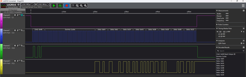

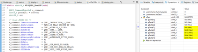

Hello again @uilter
Could you keep the receive buffer size 8 and empty uint8_t pData[8] = {}.
uilter
uilterAuthor
Senior
July 6, 2023
Hi @FBL , this is the result:

Hi @Tesla DeLorean thanks to join us.
In your experience, the way I'm reading the UNIQUE ID register is correct? Read 12 bytes, discard the first 4 bytes and consider the rest of the array.
Thanks.
Tesla DeLorean
Guru
July 7, 2023
Staging in a buffer, and copying out would be the way I'd go.

Well, your second try was correct. In the dummy-cycle phase, the microcontroller can allocate a maximum 31 cycles, however the memory needs 32 cycles to process the read ID.
Here is another option you can consider.
s_Command.DummyCycles = 31; //31 bits of dummy cycles
s_Command.NbData      = 8+1; // 8 bytes of data + 1byte as dummy
