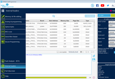

I have custom PCB based on STM32H563ZIT6 with external memory MX25L51245G(W25N01xx in schem.) and Riverdi display. I use ExternalLoader from https://github.com/cturvey/stm32extldr/tree/4dcb141b9cf6da2ee3fddf154d073bb6218a52e5/h5_mx25l51245g. Problem is that I cannot connect to the memory in CubeProgrammer. My aim is to completely program all code, images, texts and everything from TouchGFXDesigner I plan to use for pretty complex GUI so ex. mem. is necessary for me. I have attached my code and schematics to pcb.

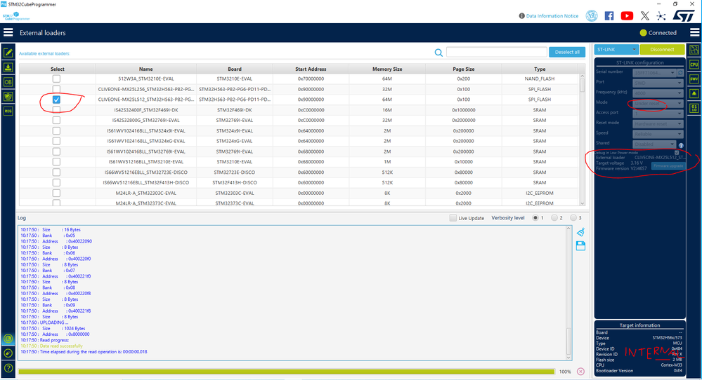

But you set it in ...mem.loader ? ->
MartinGinter
...and using/setting : software.reset + normal or hot plug...  same ?
MartinGinter
I tried, but no effect. It is probably some different problem.
