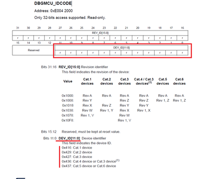

mƎALLEm
Hello @Kbruhn97 and welcome to ST community,
According to the reference manual, the start address depends on the Cat number:
For that you need to read DEV_ID field in DBGMCU_IDCODE register:
And for your question: "and can it really be true that two chips have the exact same UIDs? "
-> that's impossible that's called a unique ID. It's unique for each chip.
