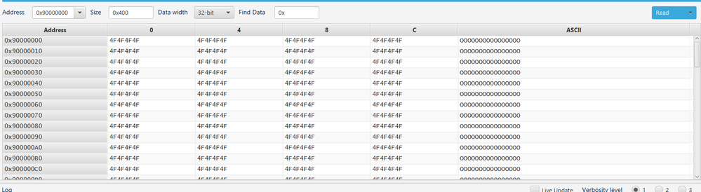

AGENDA: Need to verify the external QSPI flash (AT25Q128A) all sectors Write, Read and Comparing with STM32L496ZG-P using driver code.
APPROACH: For write, I am have created a buffer which comprises of page size of 256, and I am using two "for" loops one outer "for" loop for incrementing total sectors i.e. 4096 times and inner "for' loop as there are 16 pages for a single sector I am incrementing it to 16 times.
In below case I am trying to write letter O to all sectors and read and compare,

For reading, I am trying to read the written char from the same location I have stored in the same for loop and comparing using if condition.
BUG: During line by line debugging when verified in live expression, the read buffer is storing the written value 'O'. but if I select run in the debug session, read buffer is not storing any values it is displaying y(two dots above y with , 255). And for verification of reading i have commented the write function and erase chip function, and again i have flashed the code, this time also the read buffer is not reading the written data at the location. Using the same code(with write and read functions present inside the for loops ), when i verified with the cube programmer and on pressing the read icon, the data written data is reading at defined memory locations, even tried powering it off and on, still data is retaining, but main motive of task is to verify the memory sectors using driver not with cube programmer.

Hi @KDJEM.1 , thanks for reaching out!!
1. I am using STM32 Cube IDE version 1.14.0.
2. No I am not using any other peripherals along with QSPI driver verification.
3. Yes I had used break point at QSPI_Read() function inside the inner for loop.
Goal is to verify all the sectors of external memory (AT25Q128A) flash using code by writing, reading and comparing whether the write buffer is equal to read buffer.
For the above goal, using the above code, if I did line by line debugging by inserting break point at QSPI Read function, simultaneously i can observe the read_buffer is reading written values (refer to the previous message's photo) in live expression.
First issue is, if I remove break point at read function and run the code in debug session, the read_buffer is not performing read, when verified with cube programmer, all address location is getting displayed 255 (y two dots above it).
Second issue, from the above code, now I had commented the QSPI write function  and erase chip function (present in my code), now I am flashing the code again to read the written values, but it is not happening, instead inside read_buffer it is displaying 255(y above two dots) despite O.
Hope you got what my issue is @KDJEM.1 .

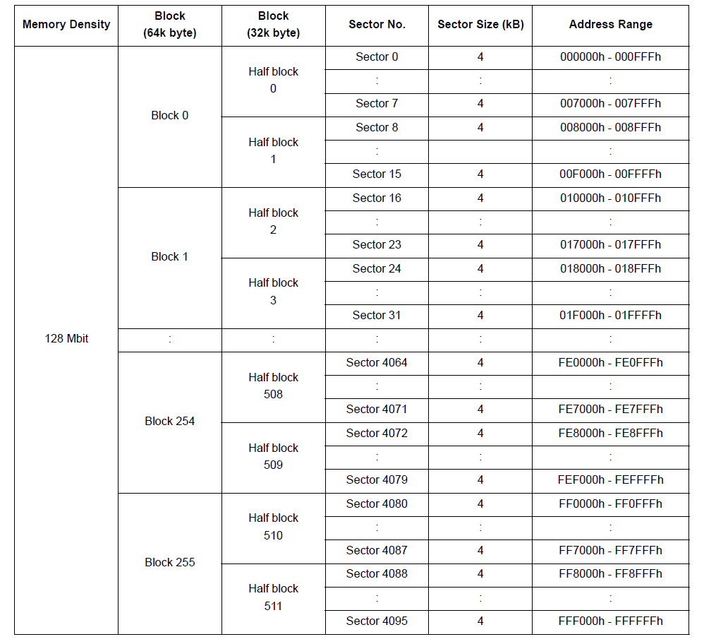

Could you please share the memory configuration

Abhiram_12
@KDJEM.1 Kindly refer to the memory configuration of NOR flash AT25Q128A
refer to the link for further references for the flash https://www.renesas.com/en/document/dst/at25qf128a-datasheet?srsltid=AfmBOorf5BWgu8polsOYEwruESDWA17LmvhnbUoboQ94GM6Qnh13A61i
could you suggest me reliable approach for developing driver which is capable of writing, reading and comparing all the sectors?
