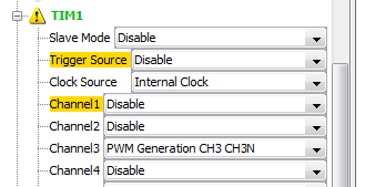

Hi have a problem with PWM on my Stm32f303k8, nucleo board.
Hi searched on this forum, but I not find an answer that solve my problem.
So: I need to have a pwm output on PB_1 Pin, and, to do this, I've used cubeMX to generate the code:

you have setup the timer for PWM signal generation on the complementary output.
you need to use;
HAL_TIMEx_PWMN_Start(&htim1, TIM_CHANNEL_3);
I tested it here on a nuc-303k8. It works.
Also, there is no need to call BASE_Start function before PWM.
it only call the enable macro, __HAL_TIM_ENABLE(htim);
PWM_Start functions also call this timer enable macro.

if you want the CH3_CH3N dual output mode, you call both starts
HAL_TIM_PWM_Start(&htim1, TIM_CHANNEL_3);

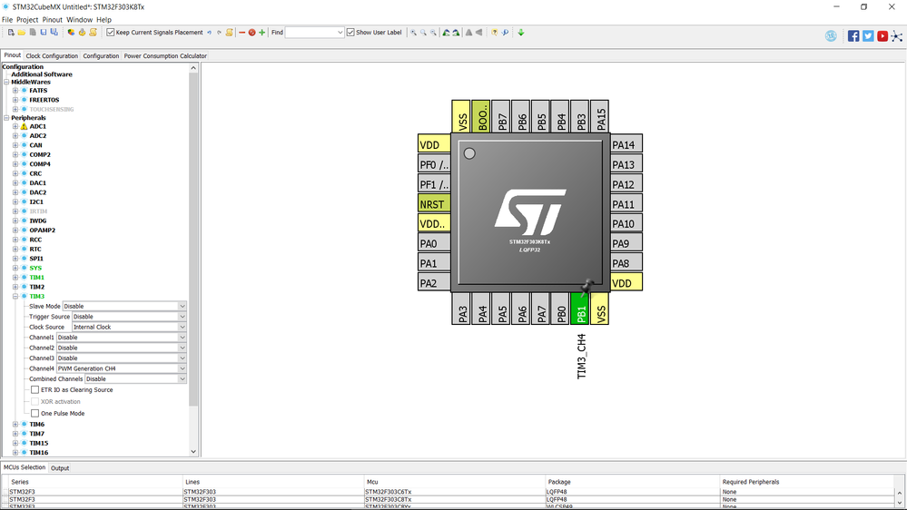

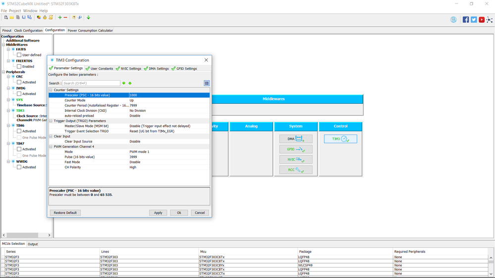

Hi, you can do this work in this way: in the stm32cubeMX you set this settings :
you can set your duty cycle and other settings in this way :
with this settings , we have 50% duty cycle with 1Hz frequency . after generating your project :
you can start your pwm in this way :
HAL_TIM_PWM_Start(&htim3, TIM_CHANNEL_4);
<write this on top of while(1) >
you can change your duty cycle with
__HAL_TIM_SET_COMPARE(&htim3,TIM_CHANNEL_4,3999);
its all thing that you should do .
