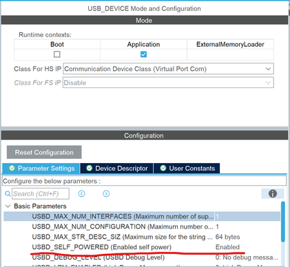

I was able to get CDC_Standalone in STM32CubeH7RS running on Nucleo-H7S3L8.
Next, I am trying to get USB FS CDC running based on the Templates_board project.
First, I need to modify the .ioc file to display the COM port in the Windows Device Manager. However, the USB regulator ready flag (PWR_CSR2_USB33RDY) is not set within HAL_PWREx_EnableUSBVoltageDetector(), causing a timeout.
I have attached the current .ioc file.
Any advice would be greatly appreciated.
yamamo2shun1
I found the solution by myself.
As shown in the image, when “USBD_SELF_POWERED” is enabled, the USB regulator ready flag is now set.
2 REPLIES 2
yamamo2shun1

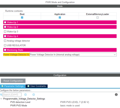

I see similar issue on STM32H7R3L8HxH using STM32CubeIDE v1.19.0 and CubeMX version 6.15.0.
We use external USB supply in design: 3.3V goes into VDD33USB and VDD50USB. PWR is configured not to use USB regulator (it is unchecked):
Based on chapter 6.4.7 USB regulator in reference manual it seems that USB33RDY does not need to be checked when using external supply.
However, CubeMX still generates HAL_PWREx_EnableUSBVoltageDetector() call into HAL_MspInit() and it fails with timeout because USB33RDY does not get set.
I tried different CubeMX options include the solution above, but that doesn't help or even can't help, because device initialization takes place after HAL_Init() where the issue occurs.
