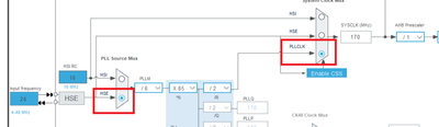

mƎALLEm
Are you sure you selected HSE as the source clock for the PLL?
EliazLB
 Yes, this is my configuration for the clock
