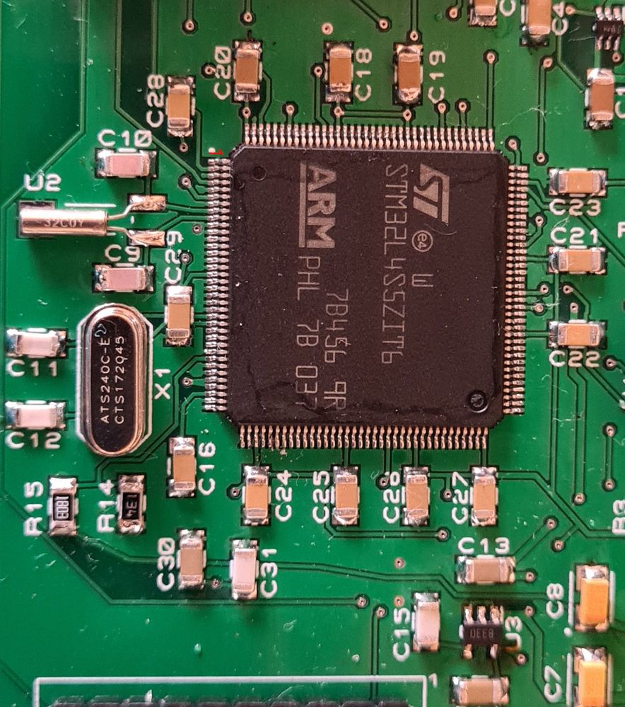

I just had my first STM32 pcb done and I've been following the reference designs and checked many times everything that there is no shorts etc. However when I power the circuitry 3.3V side draws >200mA and the STM32L4S5ZIT6 does heat up when looked through thermal camera. I did connect all unused pins directly to ground. Could this be the culprint that immediately when powered it is like shorted? It makes no sense that these pins would be output high default when power on. I'm not even able to program the chip. And yes the chip is not 180 degrees positioned wrong.
AN4555 reference design says for some reason PC3 pin (29) to connect to 1u capacitor. I used this pin as ADC to sense battery voltage. I'm not finding any explanation why this pin was connected to capacitor. Could this be the culprint?

Connecting unused pins to ground should not cause a short, as long as no code initializes the GPIO to output high. So test with keeping the CPU under reset if the high current still happens. If yes, tripple check for shorts on the pins. Otherwise check if bootloader is active, Maybe it puts some pins high. From some own observation, I thing that a single grounded pin with active high current tops perhaps at 50 mA (for F1, L4 may be stronger.
Otherwise PC3 is somehow related to VLCD. The datasheet does not explain about that. That needs to be reviewed @Khouloud OTHMAN or other ST employee

Thank you all for your answers. Just a sanity check that the orientation is correct? I'm 99% sure it is but anyhow. In the picture top left corner pin 1 and from there ccw numbering goes. Thank you in advance.0693W000008yd07QAA.jpg
Uwe Bonnes
Principal III
That is right. With the text visible normal, Pin 1 is left bottom
