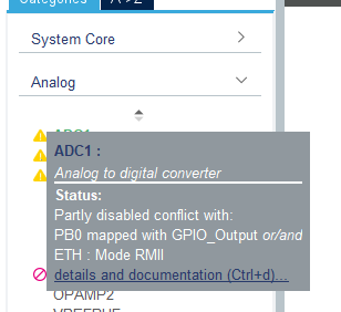

Thanks for the response!  I've shared my ADC_Test.ioc file.  How will you identify whether there are conflicting pins or not?
When hovering over the three ADC options, I *do* note that they claim to potentially be in conflict with ETH RMII:
Yet it's not clear WHAT might be in conflict.  I am not using PB0 (as far as I know).

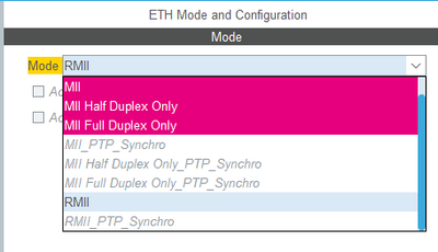

With my board, my ONLY option for the ETH mode is RMII:
If the ADCs are really in conflict with the ETH RMII...does this mean this board is not suitable to run both components simultaneously?

sorry for the delayed response but I have some questions as a follow-up .seems like there is no conlicts betwwen ADC pin PF11 and the RMII pins used.
after seeing the configuration that you are using i would like to see if you can get values of ADV conversions in polling mode instead of DMA mode.
also, I would like to know what the behavior with another ADC instance and maybe another line.
