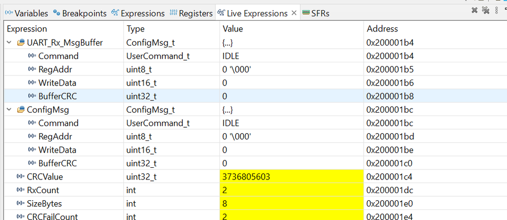

The image below shows the Live Expressions window:
I'm experiencing an issue where the UART reception seems to split the incoming data into multiple callbacks, even though the data is being sent in a single transmission. Specifically:

  1. Why is the data being split across multiple callbacks (RxCount = 2) when using the smaller buffer size?
  2. What is causing the extra zeros to appear in the received data?
  3. Why does increasing the buffer size seem to fix the issue, and how can I ensure reliable reception without relying on an oversized buffer?
  4. Shouldn't an early idle line trigger result in the received data being split differently, with no extra zeros?
