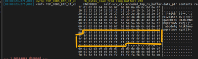

I am observing some data corruption in an external SDRAM connected to an STM32 F7 FMC peripheral and I am trying to understand what is happening and how to prevent it.
Scenario:
  • Configure the FMC to interface with a Winbond external SDRAM chip
  • Allocated a static memory buffer in the external SDRAM (somewhere in the 0xC000 0000 to 0xCFFF FFFF region)
  • SDRAM write 1: reset the whole buffer to a known value [memset(0xFF)] to be sure buffer contents are in a known state
  • SDRAM write 2immediately after SDRAM write 1, populate the buffer with my data of interest
  • immediately after SDRAM write 2, read the buffer and notice the data corruption. I.e., in the middle of my data of interest, some 0xFF are still present (figure bellow).

Is this repeatable? Is the same memory region 0xFF after reading it back? If not, I would expect this is a hardware or signal integrity issue. Is this a custom board? Does not look like a cache issue because it appears in the middle of a large buffer.
Hi TDK,
Yes. The behavior is repeatable. When reading back the buffer, the 0xFF are always observable in the same position in the buffer.
Yes. The board is a custom one.
In an attempt to check whether it could be a cache issue, I tried to configure the FMC/SDRAM MPU region as non-cacheable, but the behavior remained the same. (For context, the application is Zephyr RTOS based and I changed this setting using Zephyr's device tree: changed "zephyr,memory-attr = <( DT_MEM_ARM_MPU_RAM )>;" to "zephyr,memory-attr = <( DT_MEM_ARM_MPU_RAM_NOCACHE)>;". I could not go into the kernel weeds to confirm if this change did what I was looking for as at the moment I am not familiar with it). So either this update didn't do what I was looking for or this is really not a cache issue.
One, perhaps important, detail that I forgot to mention in my initial post (apologies for that) is that if the "SDRAM write 1" is removed, then the data read back matches the "SDRAM write 2".
Have you got any suggestions on how I could continue this investigation?
Sure it's not a code bug? Weird behavior happens after value 0x80, which is nice and even in terms of binary data. Perhaps show a complete program that exhibits the problem. I'm not sure how the OS would be involved in an SDRAM write. Surely that wouldn't be getting buffered by the OS.
Change starting address by 4 bytes, what effect does that have?
Also have the confounding factor that your screenshot shows "1 messages dropped". Unclear what that means. It'd be best to examine the memory directly using the debugger.
