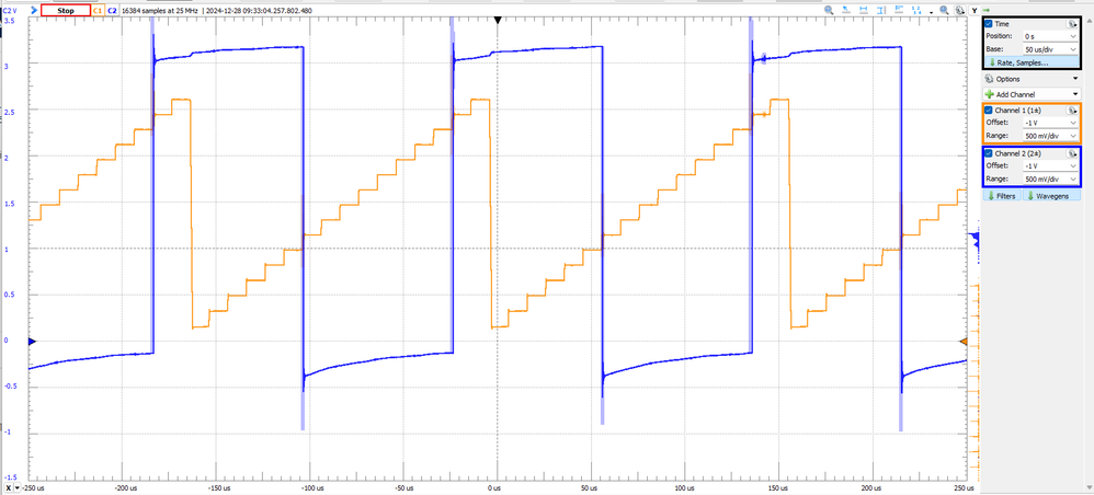

I did some tests using a defined signal to transmit on the DAC and a physical pin that goes high when an interrupt is generated. The array signal that is transmitted on the DAC is composed of 10 different points and when it transmits the eighth value I see that the physical pin goes high...so I think it is not handling the end-of-transmission interrupt correctly. If instead I create an array of only two points when it has transmitted the second point it generates an interrupt and the pin goes high, so it seems to work correctly, but only up to two points.
help me understand what you mean by RM in the DAC chapter.
The Transfer Complete interrupt from DMA comes when DMA transfers the last of data to the target. However, if DAC is set to be triggered from an external trigger (timer), data are written (by DMA) to DAC's Holding register, and are moved (by DAC itself) from it to the actual DAC (Output register) one trigger period later.
This is described in the DAC chapter in the Reference Manual (RM).
I don't know why do you observe two sample lag. I don't use Cube.
Try a very slow timer period to see this effect more prominently.
I think it is not correct to say that I observe a delay of two samples, but rather that the DMA thinks it has transmitted all the data to the DAC when in reality there are still two data points to send out.
As @waclawek.jan said, the DMA transfer complete indicates that the DMA is done, which will be before the peripheral has finished the output. Some peripherals do have extra flags for that, like TXE vs. TC flags in USART. But I don't see this for DAC.
I can confirm @MBertocchi observations like when transferring a 16-step sawtooth using circular DMA:
orange is the DAC output, blue a GPIO/LED toggled in the interrupt.
The code is at register-level, no HAL involved:

Hi @KnarfB ,
Thanks for the example.
This confirms what I wrote above: if the highest level is the last sample, DMA's Transfer Complete comes *one* trigger cycle before the last sample is output.
Non-triggered mode of DAC, and DMA triggered by timer rather than by DAC, can be used to achieve what @MBertocchi probably wants to achieve; or, if a signal/interrupt is desired one cycle after the last sample is output (at the falling edge of the above sawtooth signal), the output values table could be rearranged accordingly; or indirectly a timer interrupt could be used.
Thank you very much now I understand better, I will try to work and solve this problem to have an interrupt on the falling edge. I thought it was a bug of the STM32L452RE instead I understood that it was working correctly.
