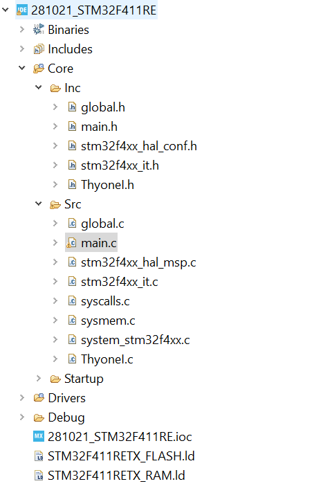

‎2021-10-28 7:41 AM
In global.c the clock is configured as HSE_BYPASS Mode with the parameters RCC_OscInitStruct.PLL.PLLMUL = RCC_PLLMUL_8 and RCC_OscInitStruct.PLL.PLLDIV = RCC_PLLDIV_2. Just make sure that your board can provided it.
But I don't think this is the issue here, in global.h SystemClock_Config() is declared as "extern" so without moving it into your main.c (ThyoneI file) the compilator should be able to find it just by including the "global.h" file.
Can you show me the structure of your project ?
BR.
AMVE.1
‎2021-10-28 8:19 AM
‎2021-10-29 2:47 AM

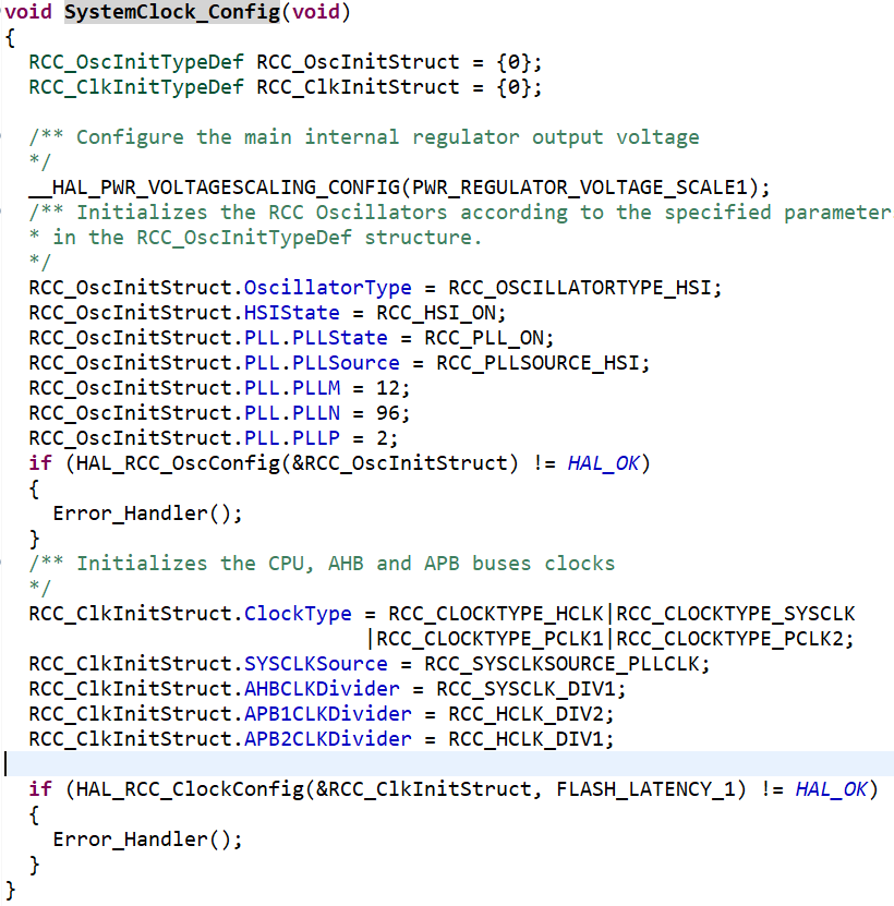

Hello CAben.1,
You need to make some updates on your code :
- In global.c ( HAL_UART_MspInit() and HAL_UART_MspDeInit() ) the USART1 configuration for the Nucleo F411RE is :
/**USART1 GPIO Configuration
PA12 ------> USART1_RTS
PA11 ------> USART1_CTS
PA10 ------> USART1_TX
PA9 ------> USART1_RX
- In global.c ( UART_Init() ) remove the lines (huart1.Init.OneBitSampling = UART_ONE_BIT_SAMPLE_DISABLE and huart1.AdvancedInit.AdvFeatureInit = UART_ADVFEATURE_NO_INIT) it's no longer available on F4 drivers.
- In Thyonel.c ( ThyoneI_Init() ) change the pins PA9, PA10 because they are already used as USART1.
- In your SystemClock_Config() I recommend you to use the HSI with the PLL ON and the parameters M = 12, N = 96, P = 2 so you will have a 64MHz of SYSCLOCK
BR,
‎2021-10-29 7:07 AM
Hello AMVE .1,
Thank you for your response. I made the suggested updates and got the project running sucessfully. Thank you.
