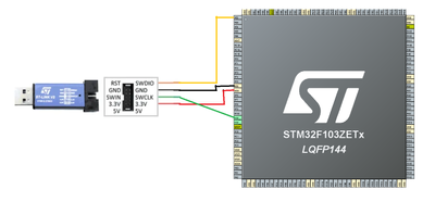

Im very stuck to reading pinout from datasheet, but I try configuration like this:
But still not connected. Btw, I just want to connect it for read flash test.

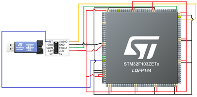

Is your STM32 on a development board? or a bare chip? If its on a board then tell us about the board like its name and make. Other wise if you are using bare chips, it still need few more connection in order to work. Like there are so many VCC pins but you have connected only one of them. Proper level on RESET and boot pins also required and decoupling capacitors also.

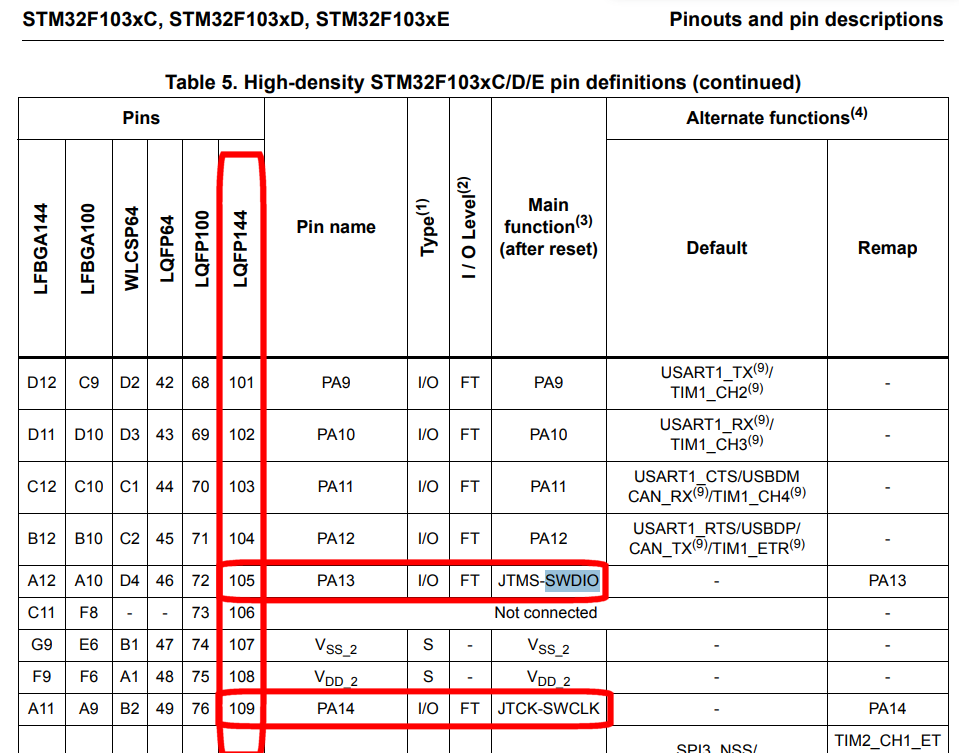

It's all in Table 5:
https://www.st.com/resource/en/datasheet/stm32f103ze.pdf#page=35
via: https://www.st.com/en/microcontrollers-microprocessors/stm32f103ze.html#documentation

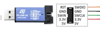

Note that this is not a genuine ST-Link - it's a clone:
See How to recognize a genuine ST-LINK/V2 versus a cloned one; in particular, this comment.
Double-check that you have the pinout correct for the actual clone you have - as noted in the above comment.
You need to connect:
  • SWDIO pin from the ST-Link to the SWDIO pin on the STM32;
  • SWCLK pin from the ST-Link to the SWCLK pin on the STM32;
  • RST pin from the ST-Link to the NRST pin on the STM32.

As @avinash_elec said, the STM32 needs to be in a functional circuit.

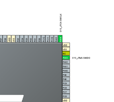

SWDIO = PA13
SWCLK = PA14
NRESET = NRST
GND = VSS (All), VSSA, VREF-
3V3 = VDD (All), VDDA, VREF+
Yeah, it looks like you're just randomly picking pins hoping for a connection.
The SWDIO and SWCLK are on the other side of the chip
