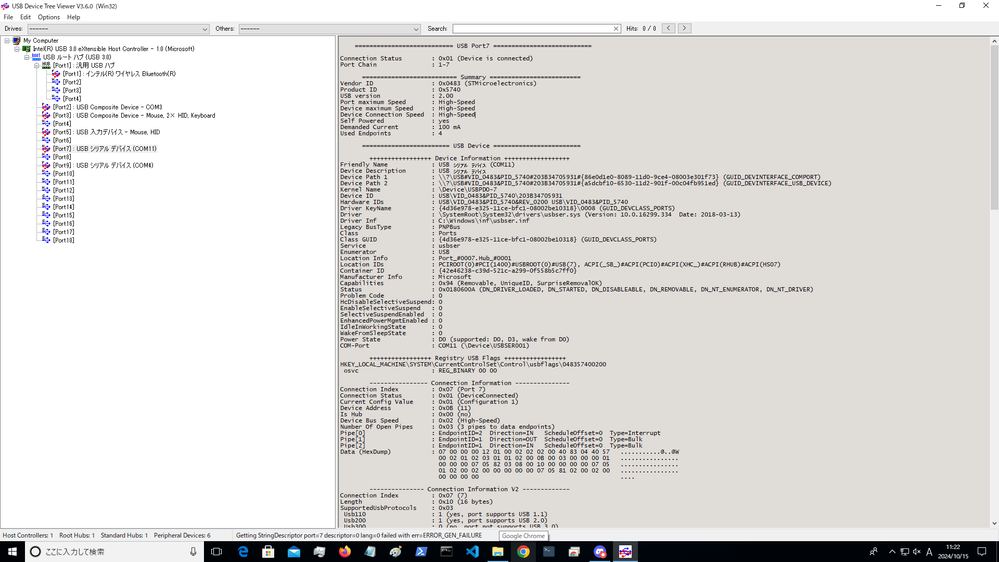

I tried your solution, and it worked. thanks so much!
But, I couldn't receive "Hello World" via the serial monitor.
code for main.c: https://drive.google.com/file/d/1qhAVHpmE8YTxBzh6OTw-7OyXdQzXE5hh/view?usp=sharing
vs code serial monitor output: https://drive.google.com/file/d/1XpSgxi50n2FgdIBYnoXeJt2oFSuEADrB/view?usp=sharing
Photo of actual setup: https://drive.google.com/file/d/1CaISDs0JhdvX8R-v1aF5v3VRw-qJxJu7/view?usp=sharing
USB Device Tree Viewer: https://drive.google.com/file/d/1VMC-ssH2HegwjDNyY9PAutBeFFSj1LSf/view?usp=sharing

I tried changing the cable(support usb2.0, U2C-MF50BK), but result was the same .
I think it is probably recognized in HS because USB Device Tree Viewer show high speed.
USB Device Tree Viewer: https://drive.google.com/file/d/1VMC-ssH2HegwjDNyY9PAutBeFFSj1LSf/view?usp=sharingusb.png
      ========================== Summary =========================
Vendor ID                : 0x0483 (STMicroelectronics)
Product ID               : 0x5740
USB version              : 2.00
Port maximum Speed       : High-Speed
Device maximum Speed     : High-Speed
Device Connection Speed  : High-Speed
Self Powered             : yes
Demanded Current         : 100 mA
Used Endpoints           : 4
