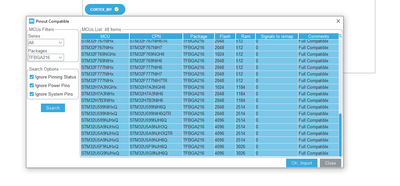

I am currently Using STM32F779NIH6 for one of our application prototypes. Currently the internal RAM size is 512KB and based on our evaluation, for certain peripherals we need a higher RAM size ( Atleast 2X or 3X). Can you suggest any Controller from the High performance MCU family which can satisfy this higher internal RAM requirement but at the same in pin to pin compatible ?

I suggest you use the last version of the STM32CubeMX (V6.11.0). Create a project using the STM32F779NIH6 then select the List of pinout compatible MCUs on the pinout Menu. You will have a full list of MCU that are pin to pin compatible and you will have data about flash and ram size of each MCU:
You can select the one you need.
