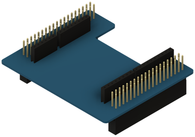

Hi @Andrew Neil
Whilst it would have saved time if there was an existing STEP file available, in the end I did my own:
I'll verify it in my own design first, but if ok will post here for the benefit of others unless it's against forum rules.

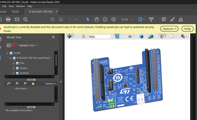

Hi @alw
Unfortunately step file is not available. Attached pdf format
I hope this helps!
Best regards,
FBL

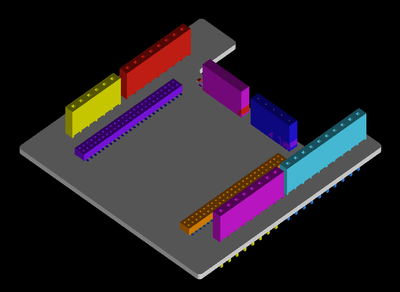

alw
Senior
Hi @FBL
Thanks, but not really useful for PCB design. I did my STEP file in less than two hours using the Gerber files from X-NUCLEO-SRC1M1 to get the board profile and a datum point for the connectors and then used the PCB from the NUCLEO-G491 STEP file as a template for the ST Morpho and Arduino connector locations. Connectors are downloads from the Samtec and Wurth websites based on the BOM information. It's the key information anyone needs for doing their own expansion board. If there are no objections from ST, I'll post my STEP file here for everyone's benefit once I've verified it mechanically.
