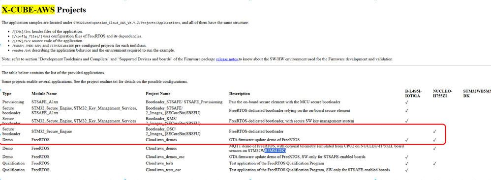

You need to port the project to match the device hardware requirements. Compatibility also depends on the security features supported by the device.
Unfortunately, in SBSFU there is no template project that supports dual-core capability on the H7 out of the box.
I suggest you start with the NUCLEO-H753ZI project and adapt it from there.

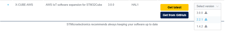

Actually, there is an ST project that supports SBSFU on the NUCLEO-H755 with a demo application. However, it is somewhat old, and the last update was on 22-Dec-2021. You may need to port the changes yourself.
You can find it in the x-cube-aws version2.2.1: link
sorry for the confusion.
