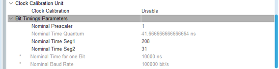

Maybe your sample point could be an issue?  Try these values which is at 87%

You sure that the UCAN has the same baud rate of 100kbs?

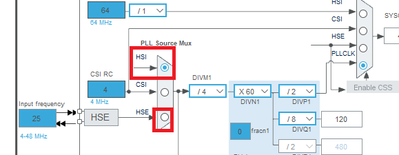

Moreover, as I see from your clock configuration, FDCAN clock is provided by PLL1Q having the clock source HSI.
It's not recommended to use HSI for CAN/FDCAN communication. Use HSE with an external crystal instead.
PS: You are setting your bitrate at 100kb/s. Are you sure it's not 1Mb/s?

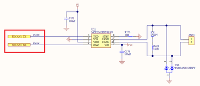

Another question came to my mind: are you using STM32H750B-DK board?
If yes, there is a discrepancy with your GPIOs settings: PB8/PB9 in CubeMx vs PH13/PH14 in the schematics.
PS: FDCAN2 GPIOs are correct.
Hello, I am using the ART-PI development board, I am sending the output schematic and documentation. I'll be back from work in 2 hours and I'll still try to change the configuration as my colleague above wrote, currently I'm at a loss.... I need to make a bridge between CAN1 and CAN2, the FreeRTOS task will not be a good solution here to transmit frames in real time. As I mentioned, such code in RTOS task works fine and I can receive and send back to the bus frames.... :(

I come back to you with answers. I have switched the clock for FDCAN to HSE, it is set to 25MHz.

System clock is not yet set to HSE (25MHz) in your latest attached project. Still set to HSI.

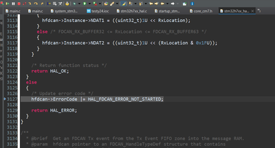

I rewrote the clock and inserted a method:
void HAL_FDCAN_RxFifo0Callback(FDCAN_HandleTypeDef *hfdcan, uint32_t RxFifo0ITs)
This method gets called!!! BUT... It gives me an error when trying to read a message from the FIFO.
I previously inserted the method, without the uint32_t RxFifo0ITs parameter:
void HAL_FDCAN_RxFifo0Callback(FDCAN_HandleTypeDef *hfdcan)
/* Update error code */
hfdcan->ErrorCode |= HAL_FDCAN_ERROR_NOT_STARTED;
sqwerize
@mƎALLEm  Problem solved!!! I don't know what I would have done without your help, in truth you have guided me to this solution.
