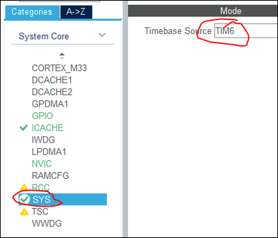

Somewhere, can't remember where, I read when running FreeRTOS SysTick can not be used for the time base. Select a timer. Note: This may have been for my target, STM32U5.
‎2023-07-07 3:31 AM
You can use SysTick in FreeRTOS. You can't use it when you want to use Tickless Idle functionality of the FreeRTOS to save Power.
If you use Systick in tickless idle mode then tickless idle functionality does not make sense as systick ISR( which is generated every 1ms) will wakeup the system every 1ms.
