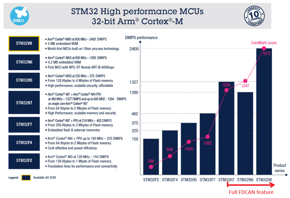

@CTapp.1 wrote:
Also available in the STM32N6(57).
Yes. Generally speaking available in the highest performant MCUs: starting from H7 (currently):
