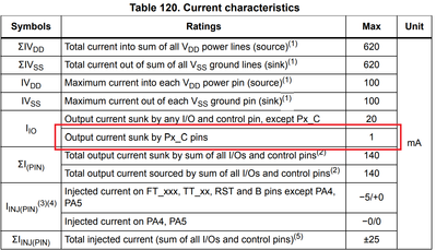

For limitations on Px_C IO, you can find the output current sunk by Px_C 1mA.
There is an errata before where some datasheets may not state that the current sunk or sourced by Pxy_C pins is limited to 1 mA when the analog switch between Pxy and Pxy_C pads is closed.
For now, AFAIK, these updates are well documented.

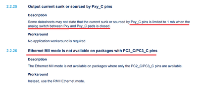

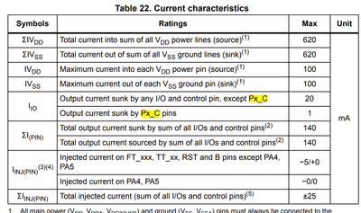

The constraint on PXY_C pins is the current as the internal switch doesn't support more than 1mA:
DS12110 Rev 10:
From the errata ES0392 - Rev 13:
Errata on the max current and the ETH function:
So you need to insure that you have =< 1mA load on the pin.
