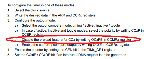

  __HAL_TIM_ENABLE_OCxPRELOAD(&htim5, TIM_CHANNEL_3);

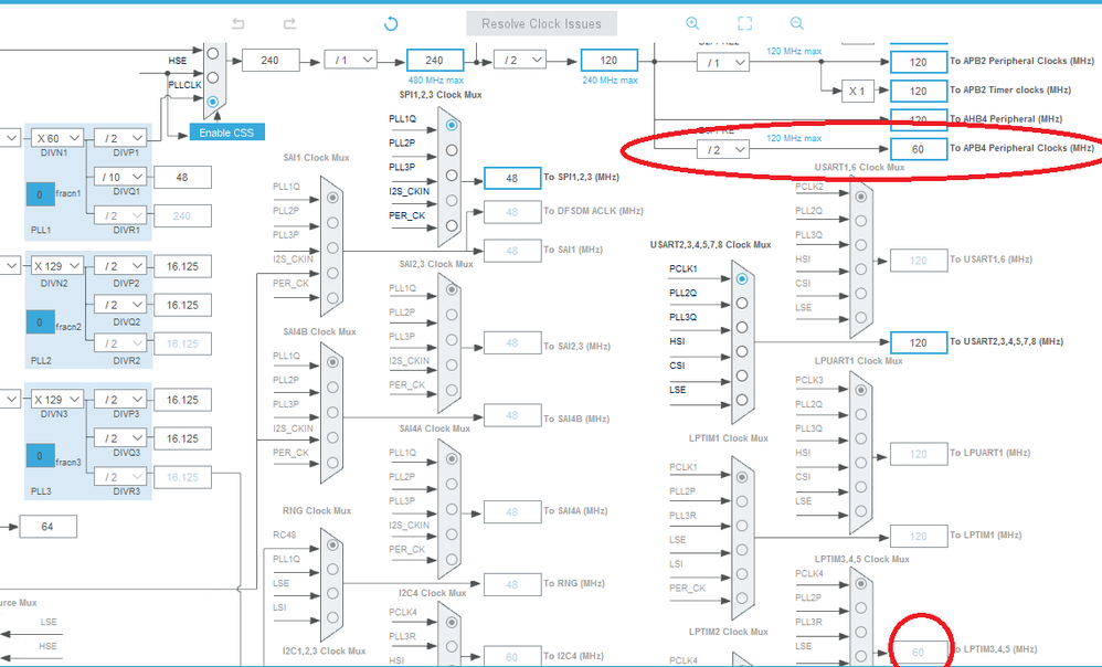

Thanks, the clock configuration for TIM3,4,5 looks correct at 60Mhz. What else could be causing it to be off by 2x?
waclawek.jan
TIM5 is in APB1 domain. Don't confuse TIM5 with LPTIM5, that's an entirely different timer.
APB1 Timers are clocked by rcc_timx_ker_ck , see Ratio between clock timer and pclk table in RM.
Thanks, the clock was 120Mhz, so the timer output is good! Maybe a little TOO good, I can't seem to stop it. I have an adc configured to trigger based on the Timer 5's Trigger event, and I see the dma update the memory with new adc data.. however, despite stopping the Timer's base and OC, I still see new data coming into the buffer! Any insight what might be happening?
