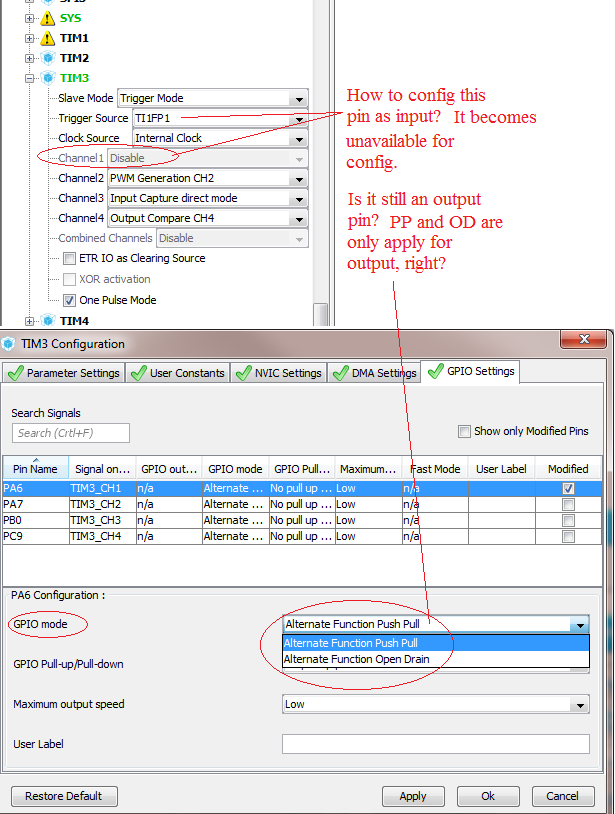

0690X00000AAIALQA5.pngHi, JW,
I am not sure and it is my concern that in CubeMX, it is still left as output since it became unavailable when TI1FP1 is select as input trigger. See the PIC.
I feel it is still an output pin since it could not be driven high.
Thanks
Read out and check the actual GPIO and TIM registers'content.
The mcu works out of the registers and does not care about what is ticked and clicked in CubeMX.
