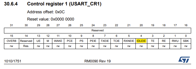

Yes UART_CR1 has the IDLEIE bit you can set to enable

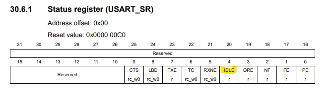

and the USART_SR register has the IDLE status bit you can check
If you use the HAL drivers you can use HAL_UARTEx_ReceiveToIdle_DMA and HAL_UARTEx_RxEventCallback
