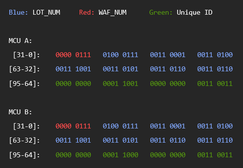

Here are my assumptions. We have 3 distinct fields:
  • LOT_NUM: An ASCII string represented by 56 bits => 7 chars/bytes. I assume that only the 7 LSB bits of each byte are significant (standard ASCII code represented on 7 bits) and this string may be common among MCUs of the same Lot.
  • WAF_NUM: A Wafer number represented by 8 bits => 1 byte. I assume that all bits are significant and this number may be common among MCUs of the same Wafer.
  • Unique ID: A unique ID number represented by 32 bits => 4 bytes. I assume that all bits are significant and this number is unique but to what extent ?
Is the "Unique ID" field really unique? If yes, is it unique among all STM's MCU/MCPs, all STM32 MCUs, all STM32L0 Series, STM32L0x0 Value Line, …
Below is the full UID registers of two distinct STM32L010C6T6 I own.

Yes, the 96-bit Unique device ID, if present and mentioned in the reference manual, is unique across all STM32 ever produced by STMicroelectronics.
Important: of course, this only applies to originals from STMicroelectronics, because counterfeits have been found without this or with the same unique ID.
In your example, the IDs only differ in bit 80.
Does it answer your question?

In addition, I whish to know if I could use only a part of the 96 bits and what are the consequences of doing so, especially given the name of the last field (i.e. "Unique ID" @ page 731 of RM0451). I am aware that the name of the field (32-bit "Unique ID") is confusing with the name of the whole identifier (96-bit "Unique device ID").
My design is a low power device with radio communication running on battery. Sending all 12 bytes of the 96 bits identifier would represent near the half of my overall consumption.
Therefore, I would like to obtain a more details description of this identifier. The filed named "Unique ID" suggests a certain uniqueness but to what extent? If this is unique across the whole STM32L0 series, I am good to go with only 4 bytes.
Moreover, if the same field named "Unique ID" is not unique at all, the ASCII nature of the field named LOT_NUM, if in standard ASCII, implies that all MSB bit of each byte is always '0'. (which seems to be true on the two samples I showed in my first message). As there is 7 LOT_NUM byte, if there is at least one more bit whose state is always known, I could at least save one byte over my communication.
Thank you for reading me. Have a nice day.
waclawek.jan
> I wish to know if I could use only a part of the 96 bits
Not if you want the ID to be unique.
Collisions, i.e. two devices may be undistinguishable.
Don't be focused on the naming of registers, it won't help. If you want true unique ID of any length other than 96 bits, you have to generate it yourself at production time, and program it together with the firmware.

DMarc
These are the answers I was afraid to read. I hoped there was a more detailed description/ruleset governing these UID fields to further adapt its use to specific applications.
However, I understand it is difficult to further constrain the UID construction, given that all future STM's productions have to comply with the uniqueness of the previous ones.
For now, we will stick to using the last four bytes of the 96-bit field and introduce a control in the production process to exclude duplicates. Depending on the rejection rate, a custom ID will be implemented.
