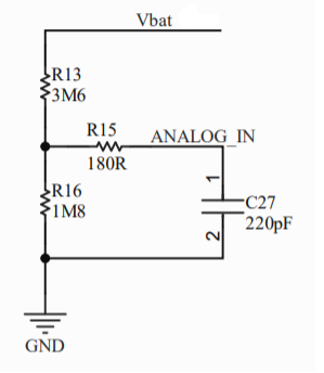

It's not clear what values of resistors, likely you need small capacitor 0.1uF in between input of the adc and ground, that may help to recharge internal S/H much faster and accurately.
Ppeyr.1
Thanks for you answers.
About the divider bridge, a picture is more efficient than words (analog_in is linked to PA1):0693W00000KZseeQAD.pngAbout the calibration, do I need a calibration per channel ? VrefInt and channel1 have not the same offset apparently.

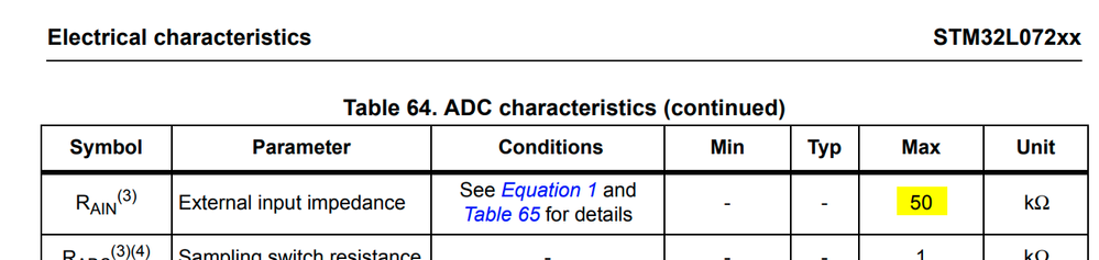

> 3M6
> 1M8
Your resistors are much too high. It's dragging down that net during the sample time. Increasing C27 will mitigate the issue. You would also need to ensure the cap is fully charged. Or, since the drop should be about the same percentage of the value each time, you could add a calibration factor to estimate the real value. You also have charge injection happening which can be significant when your impedance is so high.
ADC calibration is per-ADC, not per channel, and because VREFINT is measured correctly, it suggests your ADC is performing fine.
Multimeters use a longer sampling time and have a much higher impedance when voltage testing compared to the ADC.
https://www.st.com/resource/en/application_note/cd00211314-how-to-get-the-best-adc-accuracy-in-stm32-microcontrollers-stmicroelectronics.pdf
Ppeyr.1
Thanks for you answers, this helps a lot. I will check the impedance, and find a solution. I will come back if it doesn't work.
