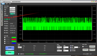

Test 1:
With the original ble_zigbee_SED_Dyn.hex source code:
1.1 When the development board connects successfully to both the Zigbee (Home Assistant Zigbee hub) and ST BLE app, it enters low-power mode with a current of 300-400 µA.

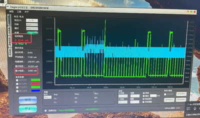

1.2 When connected only to the ST BLE app and not to Zigbee, the average power consumption is 4-5 mA, with a minimum of 2.7-3 mA.

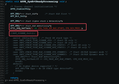

Disabling the Zigbee initialization code.
Test Results: The development board failed to connect to the ST BLE app, and the Bluetooth device was not visible in the ST BLE app.

With both Zigbee and BLE initialized, Zigbee does not connect and is set to low-power mode.
Code Changes: The code modifies the APP_ZIGBEE_NwkForm function to set Zigbee into low-power mode after a single broadcast.

Test Results: The minimum current remained around 3 mA, indicating that it did not enter full low-power mode.
Summary:
According to the test results, it appears that the Dynamic M0 firmware might require a Zigbee connection to achieve low-power operation. Is it possible to provide a version or configuration of the Dynamic M0 firmware that allows low-power operation with only Bluetooth connected and without requiring Zigbee?
