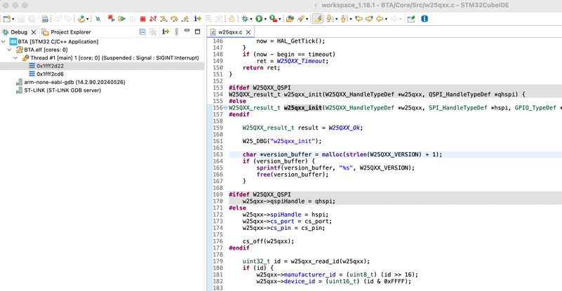

I am developing software on the Nucleo-L433RC-P board but have a strange situation when debugging.
The first time I debug, the software does not run and I get the following error...
Break at address "0x1fff2ce8" with no debug information available, or outside of program code.
Break at address "0x1fff2cd6" with no debug information available, or outside of program code.
As shown in the screenshot below...
However, the second time I debug it works correctly.
Why does it not work correctly on the first debug, but then works correctly on the second debug ?

It fails on line 168 of the 'w25qxx_init' function and then the debugger crashes.  When I pause the debugger it appears to go outside the flash area with the error "Break at address "0x1fff2d24" with no debug information available, or outside of program code."
I did not write the w25qxx driver, I got the driver from here...
https://github.com/mengguang/w25qxx
I do not understand what this line is doing anyway....
    char *version_buffer = malloc(strlen(W25QXX_VERSION) + 1);
Its strange how it also happens alternately
First debug flash and it fails, second debug flash and it works and so on....

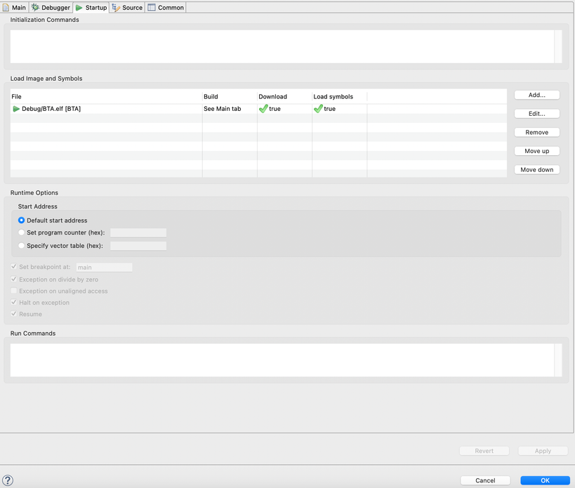

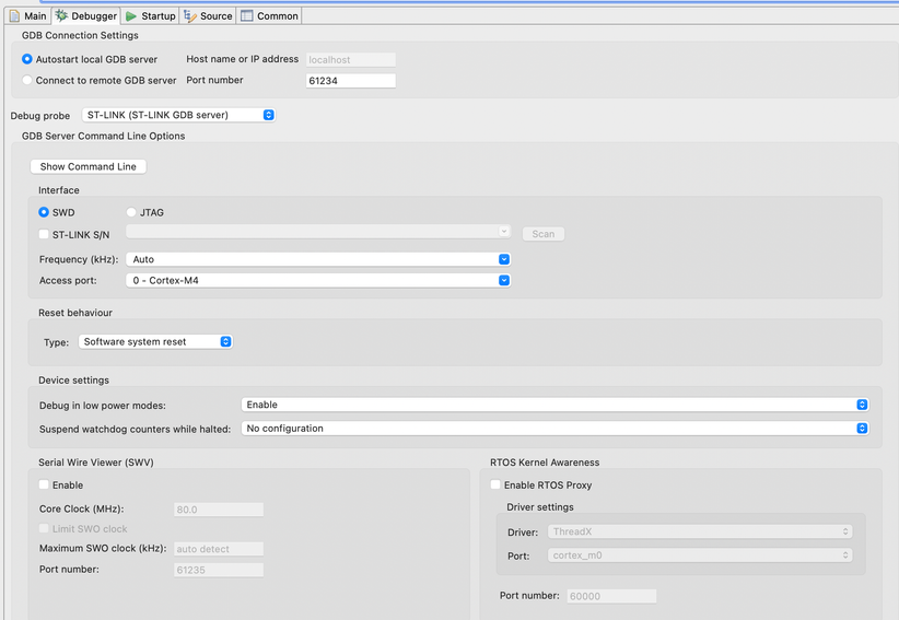

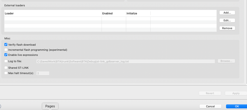

Thanks all, how do I enable Full Chip Erase and ensure my debug configuration includes program loading before starting execution ?
I cant see any options for those in the debugger settings ?
