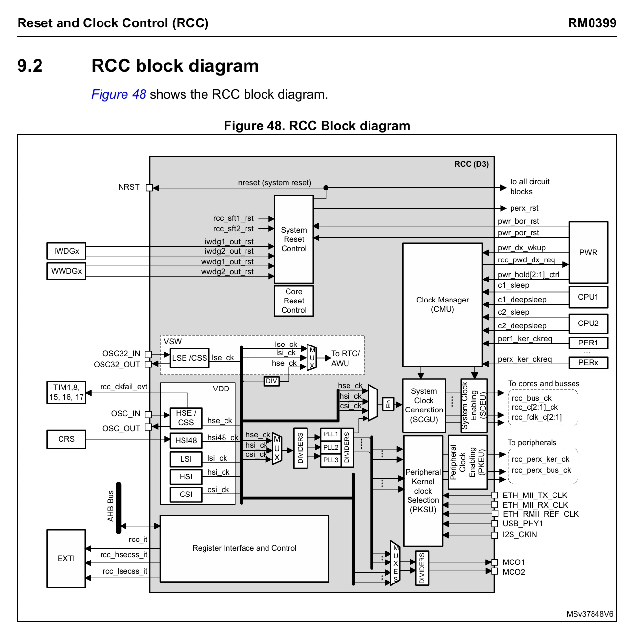

observed that both the CM4 and CM7 cores are resetting (NUCLEO-H755ZI-Q), whereas it is expected that only the CM4 core should reset due to the Window Watchdog (WWDG2). For verification UART is configured in cm7 printing counter value. observe that after some value the counter is rested to 0, that means both cm4 and cm7 is resting, using stm32cubeide for code flash.

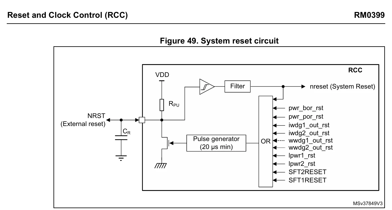

All watchdogs generate a system reset which resets both cores and most peripherals by pulling NRST low.
There is no watchdog that will only reset CM4. However, you could handle the EWI to do something similar.

My both cores are getting reset.
Correct me if I’m wrong:
  • WWDG2: Configured and initialized in CM4. I expect that if the refresh does not happen in CM4 within the configured time, then CM4 is supposed to be reset, and it should not affect the operation of CM7.
My confusion:
  • Why is WWDG2 resetting my CM7 core? I know that WWDG1 is for CM7 and WWDG2 is for CM4.
Observation:
  • I have my UART configured in CM7 to print an integer number incremented by one with a one-second delay. What I am observing is that the count is resetting to zero.
  • Similarly, we tried in debug mode, and the reset handler is being called in CM7.
TDKBest answer
January 24, 2025
