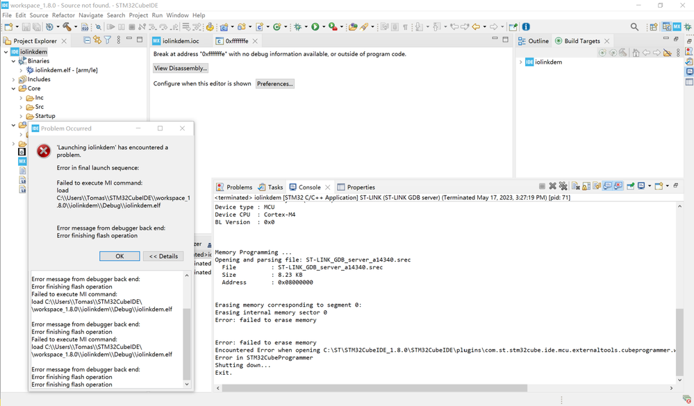

Hi guys, I am using Nucleo-F446RE board in cubeide (version 1.12.1), with basically every step was by defalut when I created new project, a problem occured when I tried to debug, as it showed " Error finishing flash operation " , anyone got any ideas? Thanks

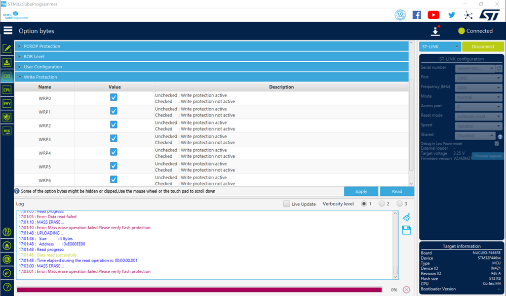

Connect the board to the CubeProgrammer and look at the OptionBytes (OB) setting, if there isnt a limitation of writing to Flash or disable debug. I would also recommend upgrading the FW in ST-Link.

Hi, I have updated firmware version to V2J42M27, and in CubeProgrammer, when I tried to erase full chip flash memory, it has error saying "Mass erase operation failed. Please verify flash protection", whereas in OB, all the boxes for write protection are checked ,meaning protection are not active.
