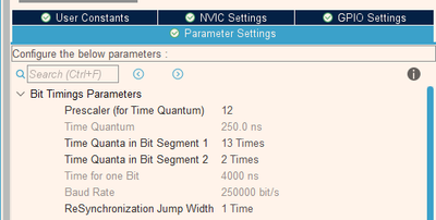

I having trouble getting the correct CAN timing configured with default 96Mhz System Clock on the NUCLEO-F412ZG eval board.
I need a 250kbit/s baud rate.
Here is what I have so far.
The system clock setup is below.
Karl Yamashita
Principal
The ABP1 clock rate is 48MHz, not 96MHz.
Try these values to get 250kbit/s

mƎALLEm
Not sure I've understand the issue.
You need a bitrate of 250kb/s but I see you got it according to the screenshot. Could you please elaborate?
