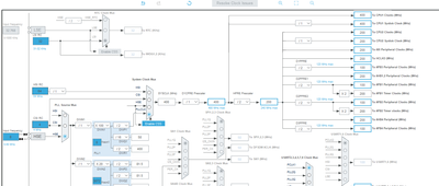

I am facing a problem with the clocks on the STM32H755ZI. When I let a timer run at 50 kHz I get only smt. like 49.92 kHz out of it with sigma = 13 Hz. So there is at any frequency a steady offset of -1.2% and a sigma deviation of 0.03%. I have chosen as HSE the Crystal/Ceramic Resonator and the APB2 of the timer runs at 200 kHz.

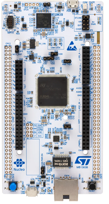

H755:
https://www.st.com/en/evaluation-tools/nucleo-h755zi-q.html

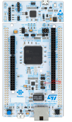

F767:
https://www.st.com/en/evaluation-tools/nucleo-f767zi.html
they both have this X4 crystal at 25.000 MHz and several others.
So do you see any way how I can achieve a higher frequency stability? Or what I might have to change in CubeIDE to activate a more accurate crystal on the H755 board?

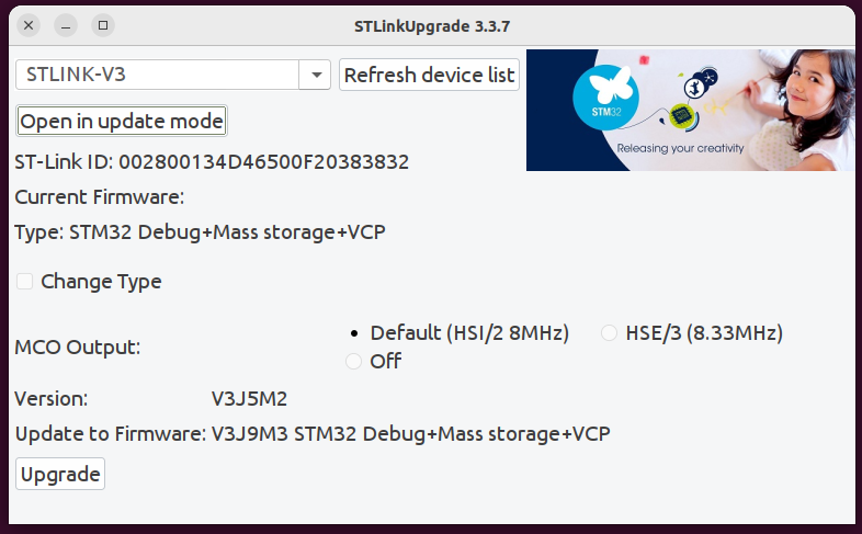

hello.How can i program the STLINK to output 8.33MHz?
program in here?
thx.
Kevin
2024-06-07 12:57 AM
@KevinNapier For 8.33MHz, you must reprogramme the ST-LINK with the corresponding option during the ST-LINK firmware update.
