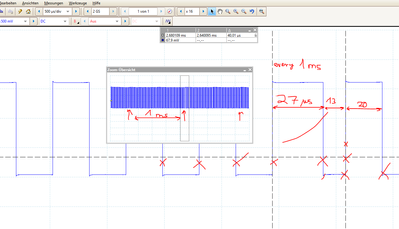

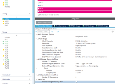

I'm working with a nucleo144-STM32F767zi and facing a problem with irregular ADC conversions (HAL_ADC_Start_IT) which are triggered by a eg. 50 kHz timer update event (every 20 us TIM1 fires an update event)
ADC Clock prescaler seems to be PCLK2 / 4 = 96 MHz / 4 = 24 MHz according to my clock configuration
So I expect the quickest ADC conversion rate to be 24 MHz / (12+3 cycles) = 1.6 MHz -> 0,625 us which is way below my desired timer triggered conversion of 20 us.
However my adc readings are irregular every 1 millisecond for one reading. In the image below I have triggered a output pin which I read via an oscilloscope.

I don't do anything with the adc value yet. When I look at the signal, I have every 1 ms this longer timing of up 7-10 us longer for one reading (the conversion takes 7-10us more time). This limit my maximum frequency to 50 kHz, at 100 kHz I have missing values! If I toogle this pin without active adc, I get a perfectly regular 50 kHz oscillation triggered by timer period elapsed callback.

It would also be okay to just find a way around this maybe via DMA? But my readings must be perfectly at 100 kHz or 50 kHz spacing, so I must be able to rely on the spacing between my values which is why I implemented this with single read and with the conversion complete callback

@TDK so you're saying that in reality the ADC value was sampled perfectly in time, and that just the callback was delayed in time? So my measurements were still valid?
Yes.

It wasn't the systick interrupt. This still led to irregular adc readings every 1 ms. After setting USB On The Go FS global interrupt Preemption Priority to 1 the irregular readings were gone. Thanks a lot!
