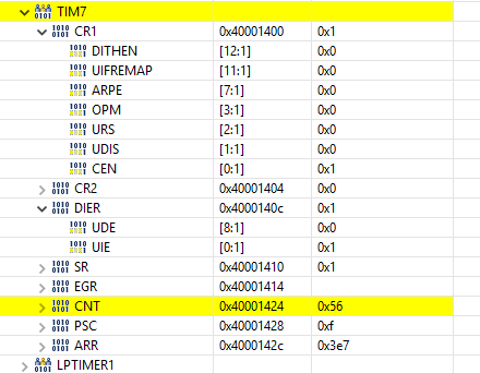

I checked the timer 7 registers which seems all fine .
0693W00000KZvjDQAT.pngthe strange thing is that both bootloader and user application runs correctly after a reset or power down - up cycle. Bootloader starts first and starts user application which runs fine. But when i use (SPI) commands to switch to bootloader and back to user application, then the TMR7 interrupt stops working.
What else can i check to find out why timer 7 is not firing an interrupt?

The moment the interrupts are not firing NVIC_ISER1 has value 0x800100, which means EXTI15_10_IRQn and TIM7_DAC_IRQn interrupts are activated. While timer 7 DIER and CR1 registers are also correctly initialized .
The NVIC_ICER1 contains the same value.
NVIC ISPR1 and ICPR1 (pending set and reset) contains also set bits, while these are all 0 when everything works fine. Can that be the cause no interrupts are fired?
I did not find a way to reset these registers at the start of the user application.
I found out no interrupt at all is fired while i EXTI interrupts and TMR7 should interrupt. Is there a register which can block all interrupts?
