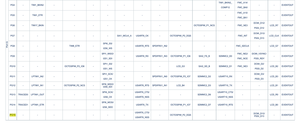

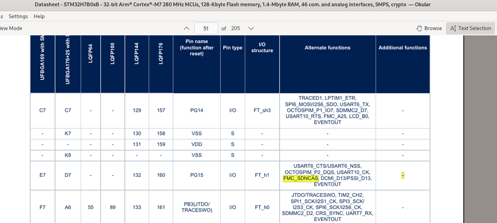

I want to design a baord with stm32h7b0zbt6 with extranal sdram chip W9825G6KH-6. I get PG15 with FMC_SDNCAS alt func in datasheet as below:
But when I looked the PG15 alt func config I get as below info, I could not found an alternate function number for FMC_SDNCAS here ?? why they are not consistent ?

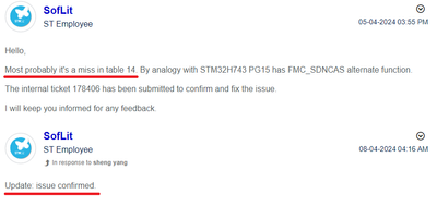

Most probably it's a miss in table 14. By analogy with STM32H743 PG15 has FMC_SDNCAS alternate function.
The internal ticket 178406 has been submitted to confirm and fix the issue.
I will keep you informed for any feedback.

Update: issue confirmed.
The internal ticket 178406 has been summitted to fix this issue.
Thank you.

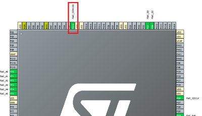

Moreover, CubeMx has already the correct alternate function FMC_SDNCAS on PG15:
The the only stuff to fix is the table 14 in the datasheet: PG15 should have FMC_SDNCAS alternate function on it.

I'm say the in the OP's top post, that both PG14 (FMC_A25) and PG15 (FMC_SDNCAS) fail to show settings in the AF Table. The RM is the controlling document, so it's important it's correct(ed).
PG12, PG13, PG14, and PG15 are not correctly documented
