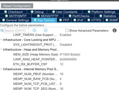

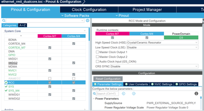

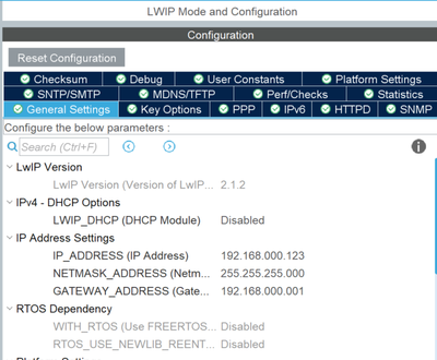

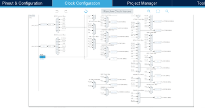

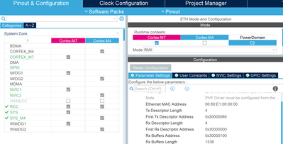

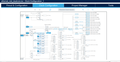

Hello ST Community,
I M USING STM32H745I-DISCO (MB1381-H745XI-B02), WHICH COME DEFAULT MII MODE, TO CONFIGURE IT ON RMII, WHAT CHANGES I HAVE TO DO IN HARDWARE, IOC. AS THIS BOARD HAVE ETHERNET IC LAN8742A-CZ-TR WHICH HAVE BOTH MII,RMII PROTOCOLS.
AS I HAVE SEEN SOME VIDEOS ON ETHERNET FOR DIFFERENT STM32 CONTROLLER IN RMII, I M NOT ABLE TO GET RESULT.
I WANTED TO KNOW DO THIS BOARD CONFIGURE IN RMII, IF YES THEN TELL ME HOW I CAN DO.
HERE IS CONFIGURATION I HAVE DONE IN MY PROJECT.
PG11 ETH_TX_EN ARM Cortex-M7 n/a Alternate Function Push Pull No pull-up and no pull-down Very High n/a   true
PG14 ETH_TXD1 ARM Cortex-M7 n/a Alternate Function Push Pull No pull-up and no pull-down Very High n/a   true
PG13 ETH_TXD0 ARM Cortex-M7 n/a Alternate Function Push Pull No pull-up and no pull-down Very High n/a   true
PC5 ETH_RXD1 ARM Cortex-M7 n/a Alternate Function Push Pull No pull-up and no pull-down Very High n/a   true
PC4 ETH_RXD0 ARM Cortex-M7 n/a Alternate Function Push Pull No pull-up and no pull-down Very High n/a   true
PA1 ETH_REF_CLK ARM Cortex-M7 n/a Alternate Function Push Pull No pull-up and no pull-down Very High n/a   true
PA2 ETH_MDIO ARM Cortex-M7 n/a Alternate Function Push Pull No pull-up and no pull-down Very High n/a   true
PC1 ETH_MDC ARM Cortex-M7 n/a Alternate Function Push Pull No pull-up and no pull-down Very High n/a   true
PA7 ETH_CRS_DV ARM Cortex-M7 n/a Alternate Function Push Pull No pull-up and no pull-down Very High n/a   true

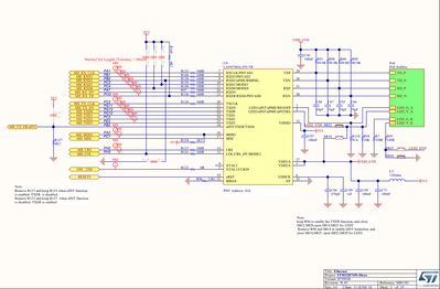

Hello @vaun and welcome to the St community,
According to the board's schematic /page 5, the configuration is MII and not RMII:

thanks @mƎALLEm for your response, i have seen the schematic its was in MII mode, i m asking do this eval board can be configure in RMII or not , if not then what are the configuration to configure ethernet in RMII for custom PCB have stm32h745bit6 controller.
No you can't configure the ETH on that board in RMII. You should configure it in MII as the board is hardwired in MII mode.
