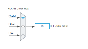

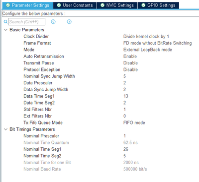

I didn't remember that I modified something on the configuration. The are some screenshots of CubeMx:

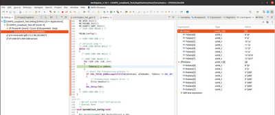

Please look into screenshot below:
We are running the code in Debugger mode.
We can see that Tx buffer is getting filled up on executing the code and once Tx buffer is fully filled with 8 bytes, Rx buffer starts to get filled, but only 2 bytes.
Can you let us know if this is the expected behaviour? Why Rx buffer is not fully filled?
Is Rx interrupt firing? ---> How can we check this? Is there any register for this?

Since you are receiving data, it's a good step.
Simply because the Tx DLC = 2:
TxHeader.DataLength = FDCAN_DLC_BYTES_2;
Need to modify it to be:
TxHeader.DataLength = FDCAN_DLC_BYTES_8;

Hi Expert,
Modified the DataLength parameter to below one and now Rx buffer is getting filled. Thanks for the response.

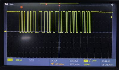

Then we disabled the debugger mode and simply booted our system. At this point, we were able to see continuous activity on Tx pin as below
Cannot understand why it did not work when MCU was in debugger mode.

Since the first issue has been solved : Frames are seen on Tx. We can close this thread.
Please open a new thread for this behavior on Debug mode.
